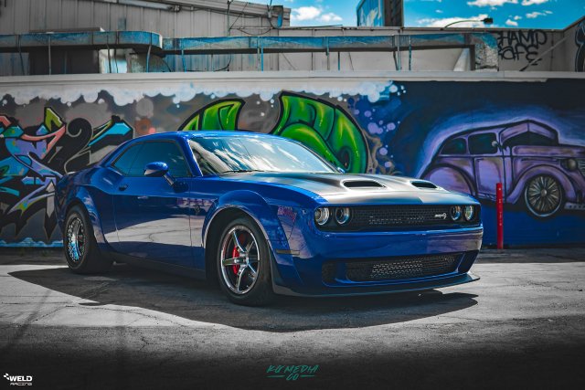

Pulled from the Weld page. Just do it!

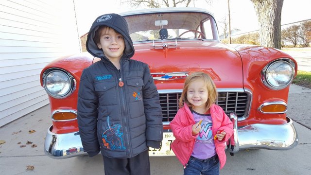

I have 55 chevy 210 on deck and my brother has about 3 chopper projects going on currently.
Pic is a few years old. Getting a rebuild.

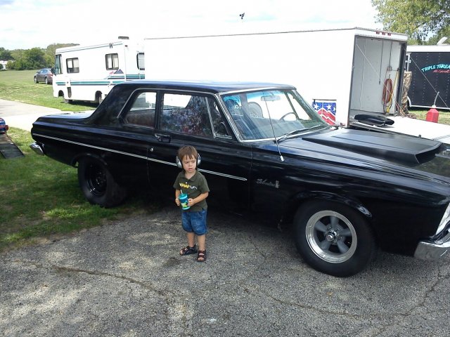

My brother's Belvedere. Getting a fairly wild 440 built now. I forget the specs but the goal is easily mid 10s on motor.

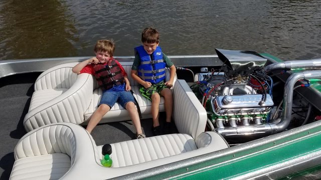

Then the Jet boat.
Then the Jet boat.
Some good stuff man! Lol @ that boat! Damn! That's whats up!
