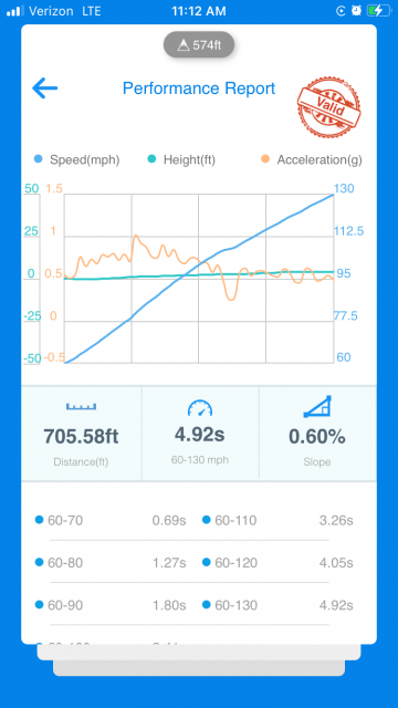

I was just teasing ya, but I’m sure you have a 5 in that thing with couple more tweaks. It’s tough with the M6… With the gearing you have now, what gears are you using?
This is my brother’s most recent. Turbo Camaro.

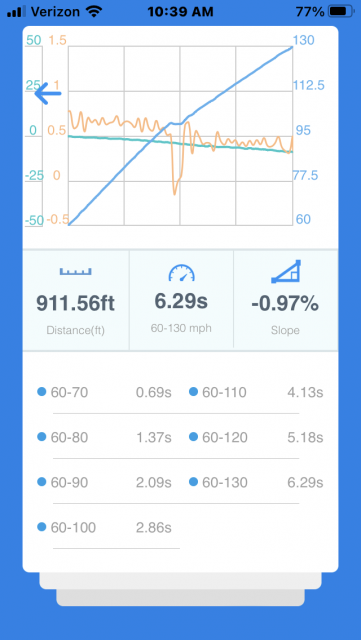

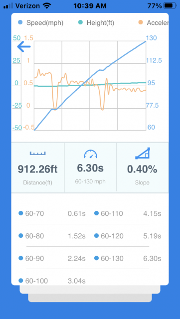

Nice run!! An auto gains you 1/2 second they say. Last trans with 1.43 third and 3.70 rear I only had to shift once, new trans with 1.30 third and 3.90 rear I have to shift twice, wish I could have the 1.43 third in this 2.66 trans I would have kept the 3.70 rear. He any where near Pocono in Pa? Roll racing a few cars there running high 4’s low 5’s, be some competition for them!! The Gtech shows I’ve run 5.90’s, unfortunately I don’t set the draggy all the time and miss some good runs, I’m back on gasoline now for the winter so missing some good air to get some good passes in. Installing a turbo kit in the boys RX-8 is killing me as far as time for anything else of late. I’m hoping to up the boost for next spring and be in the mid 5’s

We are in the buffalo area, but he just got the car back together in time for the tracks to close, lol.
