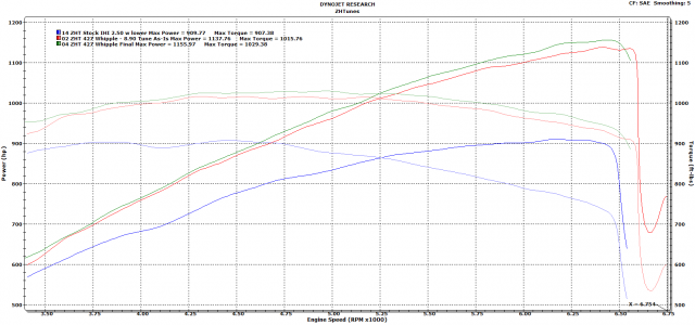

It may be a surprise to some folks, but I never had a chance to dyno the new build before I ran the 8.9's last week. After making several 8 second passes, I decided to change that fact and see how much power she's making.
The 8.90 tune as-is made an SAE corrected 1137 WHP and 1015 torque. After a couple tweaks, I ended the day with 1155 WHP and 1029 torque.
Dyno Vid:
Here are my dyno results comparing power made on my previous stock motor setup with a 2.50 + lower versus the built 427 Whipple I'm running now. ZHT Pullied Hellcat Blower vs 427 Whipple.png

Congratulations, is this the race motor whipple build? As I recall 428, right?

Sorry, just looked at the bottom of the dyno graph, 427

Was the stock blower on the same 427 longblock?

No, my old build was a full bolt on stock sealed long block with stock unported IHI supercharger.
