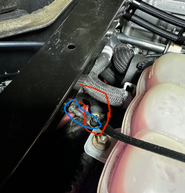

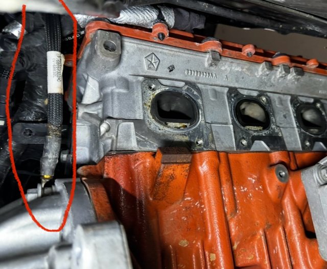

Left Battery connected Pulled grond at trans Motor has a redundet ground from front of engine to shock tower grounding point for jumping car
Never seen that before, I have nothing going to that post. Must be on the newer cars

Yes Jon sent me an answer to check continuity of ground cable it checked to be good but I went ahead and replaced it anyway we will see what happens in the morning

Which ground cable?

I’d start looking at a wiring diagram and see what ground circuits are in that smaller ground cable. So you removed the starter with the battery still connected? Car running or not, there’s power if you didn’t disconnect the ground wire when pulling the transmission. Always pull the negative battery terminal before disconnecting anything. I would get Alfa obd it’s free to use (for a short amount of time), but you need the obdii dongle. My fuel light would blink and I’d get a message (service fuel sensor) but no codes. Scanned with Alfa and it told me there was a BCM code stored for a short to ground on fuel level sensor B, which was great because it told me which floater went bad (the cars have 2). You replaced everything I would have looked at as the first culprits (battery, alternator, ground strap.) you checked your intelligent battery sensor? It’s the connector on the negative battery terminal

Since I replaced the transmission grond cable the problem has not resurfaced not saying its fixed and its only been 2 mornings heres hoping

Good deal, thought it might be related to that ground cable - not thing you really could have touched swapping the trans, having done it before myself. Keep us posted
