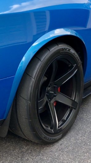

I’m pretty much in the same boat as you. I currently run my Nitto 315 r’s on an 11 inch rim at 28 psi as well. You can see my chicken strips (that’s what we called them on motorcycle tires) on the edges so I should probably drop down a few as well. They haven’t got too squirrelly so perhaps another 2-3 lbs. wont hurt. 4475F661-5E38-46AF-8951-BE3FD90C260F.jpeg

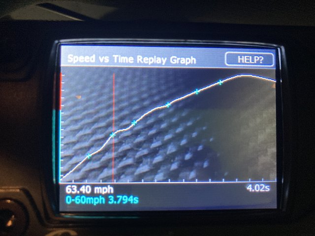

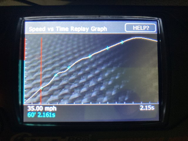

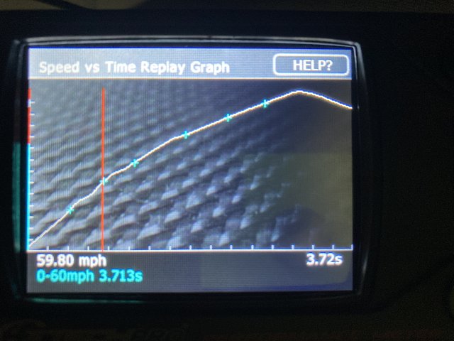

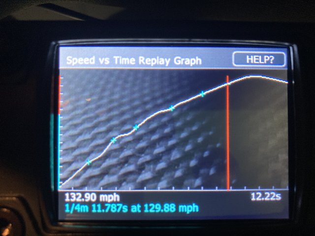

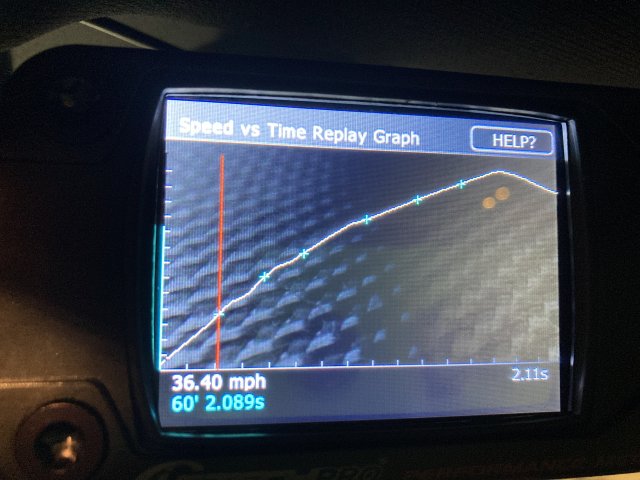

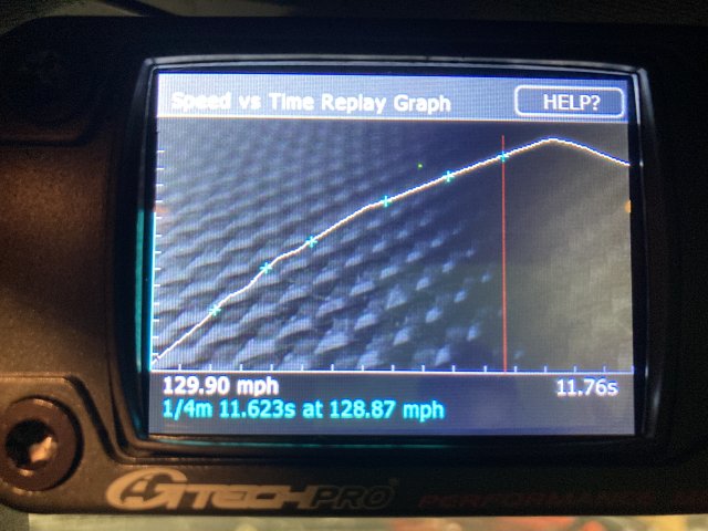

I keep both the 315 555R2’s and the the NT05R at 26-27 psi cold for street use. With no burn out they do pretty good on the street, ran this 11.6 last night with a 2.08 60’ and a 3.7 0-60
I run 315/50-17 MT Street R’s at the track at around 17-18 psi cold, did a 1.39 60’ with them once and ran a 9.998 1/4, my best ever and only 9 second pass. (M6 Challenger)
My goal is 10.9xx street 1/4’s, no burn out, just launch like from a red light. These passes on 93, Be back on corn soon and I see 9.x coming before Fall arrives 🤞
Both these passes last night, 1900 DA
Second run
55C6E19F-F9B8-4974-AE9C-AB300B45711C.jpeg B8B35309-2DD1-4A19-B799-E980F650046B.jpeg 810128EA-9A87-465F-A8AD-0286BCDC754E.jpeg
First run
D7864B50-9AF2-49D9-A17E-471A225B9BF5.jpeg 05ED1632-7231-40DD-B7B9-EBF1685B0913.jpeg 9F82C3B8-5FC9-4DC6-9E18-B9285323951F.jpeg
Cars very consistent of late with the new steel bell housing, shifts butter smooth now. Nitto’s are my street tires hands down.

Alot left in the car with that trap speed. As we all know, street launching these cars is the trick. I did not run 315s (though measurements said it would fit) but on my 305 MT Street SS and Nitto 555Rs I ran at around 28 cold on the street. had even wear all around (front OEM, rears 20 x 11). I was also anal and left the tire pressure display on at all times so I could watch the changes real time.

Yea, no doubt could do better time wise if it can be applied better in the first half of that mph lol. My best street trap speed on corn was 142 so even with that 60’ time I’ll knock 6 tenths off up top I’m hoping to get in the 10’s on the street on the 315 Nitto’s🤞
