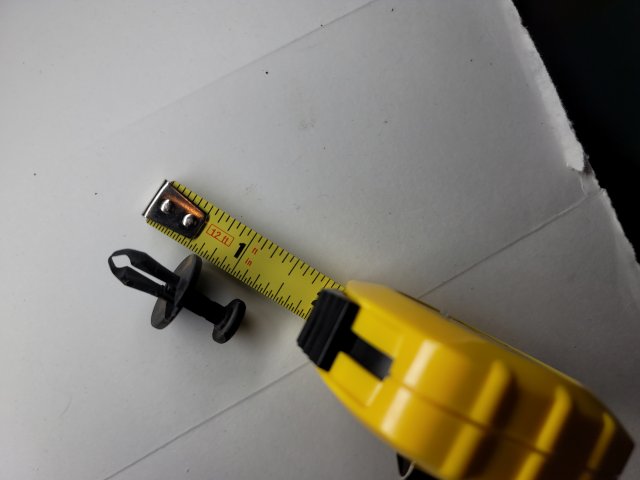

Perhaps another option
edit, let me know if you want me to measure width with caliper?
7,727
6,535
Appreciate it, but I think those are too big as well (and first option I tried). Will have to see if the dealer can give me actual dimensions. They usually do on fasteners and tell me not to buy from them because they’re 5-8$ a piece. I’m looking for the ones that secure the fender liner to the front bumper

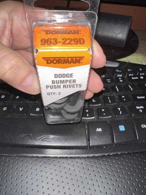

getting close to finding them
7,727
6,535
Thread Starter #14
Hmm, what I ordered appears to be correct. Annoyed. Wonder if it’s because my lip is new

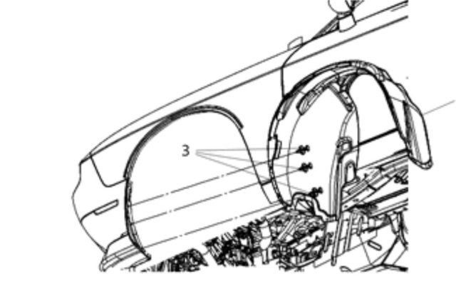

Maybe it's this one, these are slightly smaller, there are 2 per side for this one.
6509049AA
