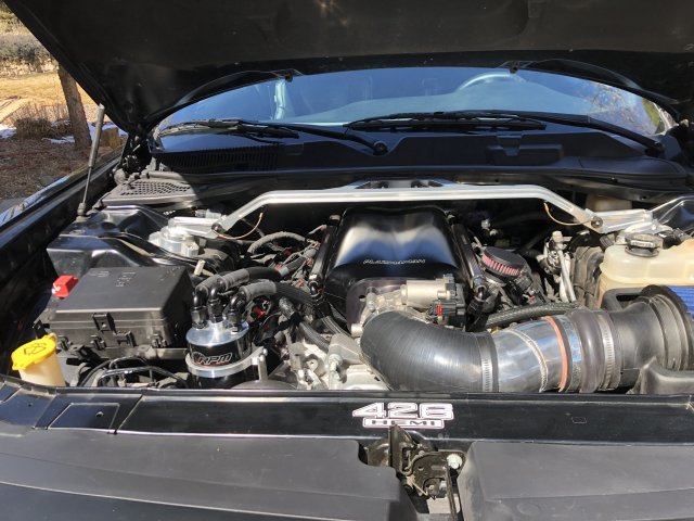

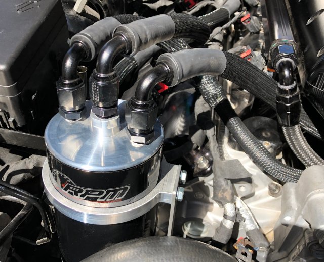

Finally ALL done with the build. Last bit was new billet rocker covers, oil separator and corn tune. Really diggin’ the new separator. Installed a Tazer & bypass today for line lock, PIN security system and speedo tweak for non-stock wheels & tires.

Nice oil separator, looks sweet

LOOK at that tower brace!

Wow thats a hell of a catch can! Where do I get one of those bad boys?

Glenn Rains at RPM did my build. I think those are made for him. Vents from 2 locations with a check valve for wide open throttle. Don’t know if he sells them separately but worth a call...
https://rpmdenver.net
