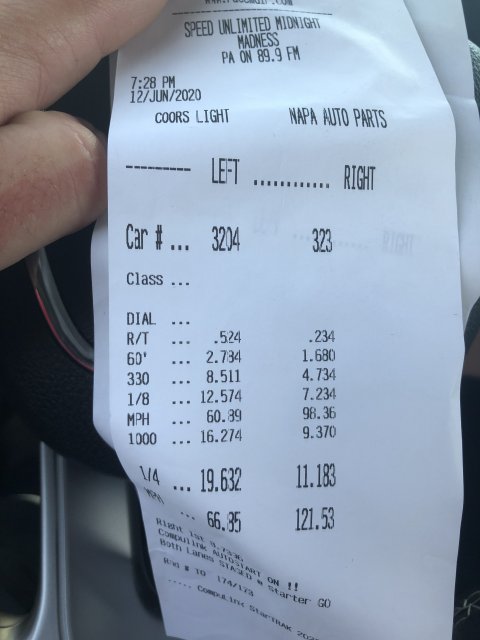

2019 hellcat challenger auto only mods forgestar d5 front and rear wheels. 4655lbs with me in it 1440 da. Car number 323 on the time slip. Is this the normal for 2019s? My 2016 ran 10.86 same wheel setup in negative da

Others with direct experience will have to answer, I've seen a wide range of times from around your old time to your new time.

There were some thoughts sometime back about 2016’s having a little more aggressive stock tune than later models? With that 60’, I assume you had some drag radials? Was that run at MIR? MPH seems a little on the low side. For comparison, Vortecd just reported a 10.99@126 in similar DA in Michigan with a stock full weight 2016 Charger just with a green air filter and 275/50/17 DR’s. His 60’ was also almost the same.

Yes it was mir it has p30545r17 street r drag radials

MIR is a fast track. It will do better. What was your custom mode settings?

Traction off trans track suspension street steering street 1500rpm foot brake. The mph concerns me I know da affects it but 4mph seems like it’s pulling timing? I’m running 93 octane would unleaded race fuel help when the weather isn’t good?

ET of 19.6 for first time out.....not bad! ;-)

That was me on my motor scooter, lol

Stay with it , some times my car has to figure out what I'm trying to do and after a few passes it gets it.
So, I think you will probably pickup .5 sec. JMO

Maybe the '19's don't have as an aggressive tune being they are speed density? I know someone that took out a '19 last fall in 500 DA and ran 11.1@124

Also did you run both lanes? 1 lane at our track last year was 2 mph higher. I was trying to do some air filter testing so I ran the right lane every pass

Congrats OP , good for first time out but your car is heavy , how much gas was in it ?... high DA vs. negative DA is a hp killer , for every 800>1000 DA difference , is a tenth in ET.

Cmon....11.1 does not sound like "its too slow" by any means...right? I mean 10's aren't far away, and its basically all stock. The wheels were mentioned...depending on how tall or short they are would effect mph....or no?

The three passes I made were in the right lane. Car had a full tank of gas and I’m 250lbs lol.

How much fuel in your tank and your weight over mine is over a tenth. I run with under 1/2 tank
