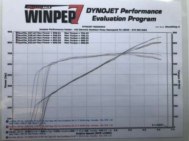

After months of debate and talking with 1/2 dozen of the premier Mopar tuners over the summer I’m finally in the process of doing a Flex Fuel Tune on my 16 M6 GoManGo Hellcat Challenger.
For the last year + I’ve been running the same tune on a 2.85 Hellraiser and ID1050X injectors that started out at 775 wheel spring of 2019 and with small component additions here and there has been putting down 855 hp/ 710 Tq on the same tune since early spring this year but I’ve always envy’d the torque corn produces, the risks of pump 93, and hearing many say once you go corn you’ll never want to go back and reading of @Speedy! success with a OST Dyno flex tune using his old ID1000 injectors and loving it here I am to see.

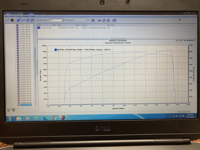

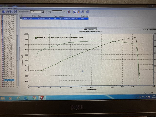

Ok, the long awaited day has arrived, the first dyno figures. It’s been a looonnnggg haul, literally, I bet I put 1000 miles on my car since starting this endeavor 6 weeks or so ago. Most of the delay was in getting the Alcohol content to read correctly, seems it takes spot on fuel trims for such and had to go back to 93 and forth between 93 and E and I learned that running to empty and filling to the brim is not the way to do it as if you have to switch back there’s allot of driving involved to burn it off especially 93. BUT it’s payoff has finally come full circle!! Conservative tune so far netted 934 HP and 787 ft lbs tq on a E 77.5 reading. Local track closed already for track data but Street 1/4’s show a marked improvement, I’m ever so close to my goal of a 10 second street pass with a M6. I Went from consistent 11.4-11.6 133-134 1/4’s to Sunday doing 4 1/4 passes within 5 minutes of each other that ranged from 11.2-11.3 at 137-138 mph with crappy 2.0 60 fts and 3.5 0-60’s. My goal has been consistent 10.9x at 140, I’m close and I think I’ll get there with tune tweaking as long as the road doesn’t get too cold to quick MUCH THANKS to close buddies for their help and support in getting to this point, THANK YOU!!
D1691045-A8AF-4633-AB9E-02E1377A812F.jpeg CB5CB79D-D4D6-4F9C-8A16-FE2E36816452.jpeg
Look at that Torque hump!! Amazing what $2.21 a gallon fuel can net!!

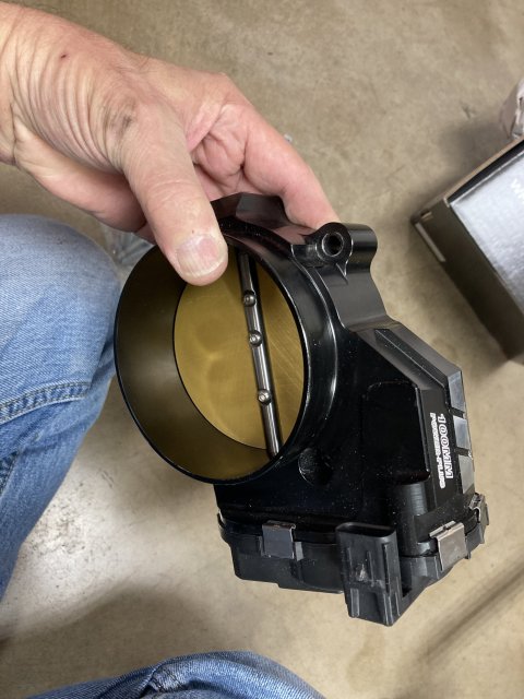

Thread Starter #13
3C439921-8776-46B1-BE71-26EA520882AA.jpeg 5E379AD7-9BDE-4064-8DB3-8D6683332608.jpeg 100mm BBK installed and ready for testing, will dyno in the near future and see what it adds compared to the 95mm Fastman

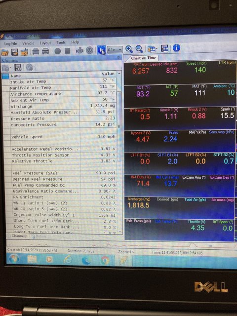

How's the injector DC? Who's tuning?
Yes the injectors have to be scaled spot on for trims in order for flex to work properly.

Plenty of injector left yet
