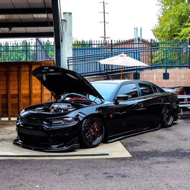

Beautiful cat and welcome. I have an 18 Charger Hellcat (February 2018 build) and have luckily not had any issues. My suggestion would be to throw a new battery at it to rule that out. Sorry to hear. Please keep this thread updated...again nice Hellcat.

That is a badass looking beast you got there :)
