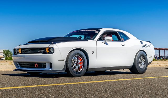

Also.... in case you (or anyone else) is wondering how it sits on those 1320 springs.... and that’s on a 31” tall tire 754B2C72-A2F1-49E8-BC30-BE644CA493C2.jpeg
