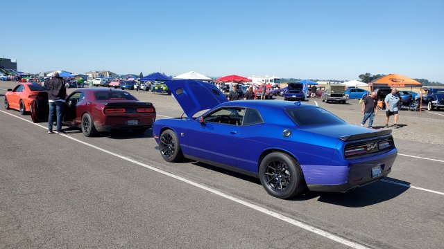

Welcome.
Love the input.
Any pics of your car?
This was last year at the Mopar Nationals in Woodburn Oregon. Made it to quarter finals in Modern Mopar category. This was before I got the skinnies in the front. No more tape either. The MT drag radials don't spit much rubber off them which is great. 20200719_101334.jpg
