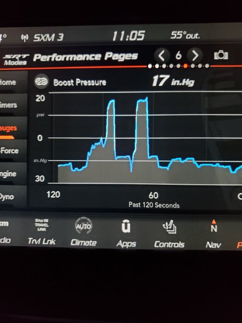

Making 17 psi in the upper rpms with a temp at 55. It stayed pretty solid on 17 psi when the temp was in the 30's through 20200110_230558.jpg 4th and 5th gear.
Hopefully I'll have track times this sunday.

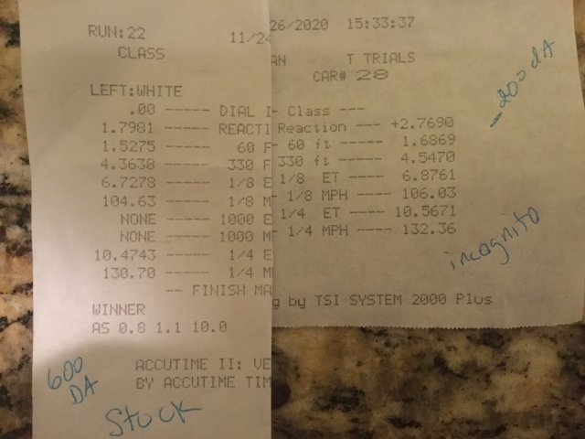

Hit the track today but it was spin city. It was loose in first and second so I’ll have to wait till feb 8th for a good comparison. These are slips from two different tracks. image.jpg

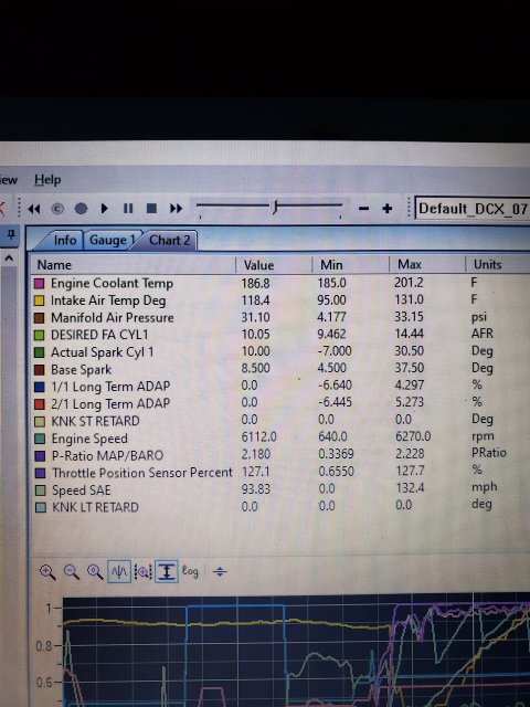

That thing is going to the Floor of AFR because of the stock Cat ove-rtemp protection by the looks of your logs. My guess is you will for sure be using the warranty if you keep running it that way. The entire argument that this part or any other part being tune free and preserving your warranty is really bad. Not to mention the Pulley in itself is impeding the ability for the elastomer in the balancer to function properly. It will be interesting to see the long term effects on the engine.

Ok but I’m confused on the cot I guess. I have stock logs showing my car doing the same thing to the a/f. Hell when I drove it stock this summer and beat it hard the cot was on the whole time. I had another redeye member verify his did the same thing b/c I thought something may have been wrong. His acted the same as mine does and other members have reported the same thing. I do plan on your tuning next after I’m done with this and have been in contact with Tim. I’m just trying to keep all this information straight. Now for your statement about the balancer we will have too see on that.

Just by the mph you definitely made gains.

If you were able to overlay the info you would find with the additional boost and reduction in ignition timing that you are entering Cat over temp earlier and more often. Another feature of the stock PCM is that if it goes into the thermal spark strategy the PCM will add timing in an attempt to cool the catalyst. This theory serves true for anything one would do to increase boost on the stock calibration.
Hope this helps

There is no such thing as a free lunch.
