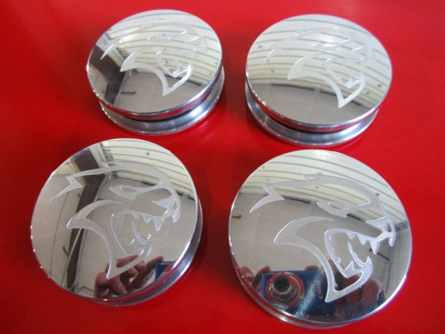

I was going to do the wide body convert with a set of DM-840 wheels.
With these centercaps
2fast4u
#1136
1,001
2,516
Edwardsburg
Wow, those caps are something else...can you get them in black/matte grey w/head outlined?
TMAC
#998
211
315
Mesa
2017 Dodge Challenger Hellcat
Got them off Ebay. Not cheap. The guy had one other set left.
