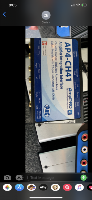

No I got a 6 ch JL amp for the door speakers and a 2 ch for the sub. You have to get an AP4 module tho to get everything right including door chimes etc you cannot skip this step lemme know if you got questions
