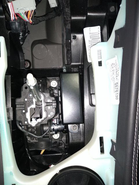

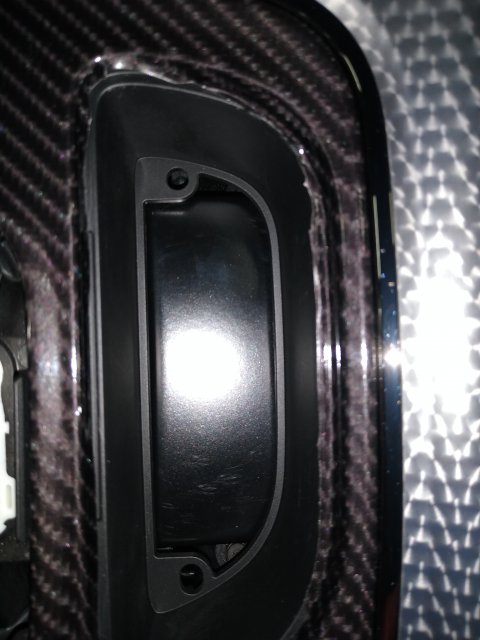

I made a metal cover to go over the neutral pull mechanism. Hopefully when they get in to put it in neutral they will realize they can't get to the pull and walk away. IMG_20201218_163045705.jpg IMG_20201218_164535922.jpg

I actually made a batch of them that I have been selling on another forum but wasn't sure I should post them on here being the new guy.
Reach out to @Hunter or @BULL and find out what you have to do to be a vendor here. I'm sure there's some rules, but I have no idea what they are. Those guys would know for sure.
I wondered about a product like this when I saw that video of the guys pushing that charger after popping it into neutral.
