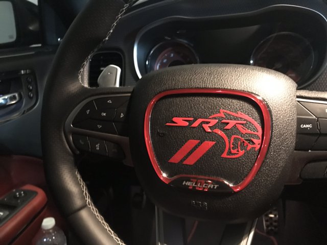

One of the more disappointing things I've observed, is the finish on some of the interior components. For example, the steering wheel airbag trim. The "chrome" they use really sucks. It scratches easily and rubs off.
I considered the lighted airbag mod, but after laying hands on one, I found they suffer from the same quality issue.
I may just replace it with an eBay carbon fiber piece.
Anyone else have, or had this issue?

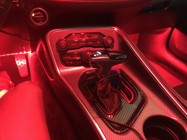

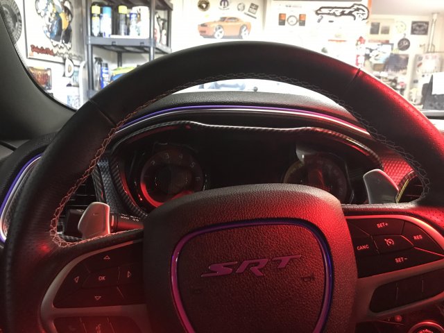

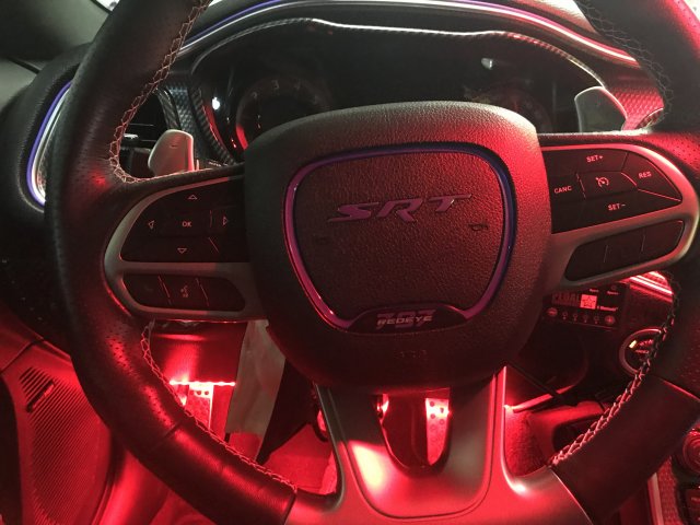

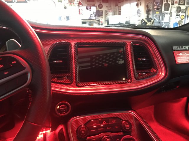

@Matt someone with an SRT we think alike. I really like my red LED’s in the interior. 8461F48A-B758-4BB4-89EF-B0AA71153631.jpeg 1FB8AE12-1DF4-438B-AB46-2FF8DBB43337.jpeg E3381AD1-BF0F-4F6C-976E-00050A9DB558.jpeg

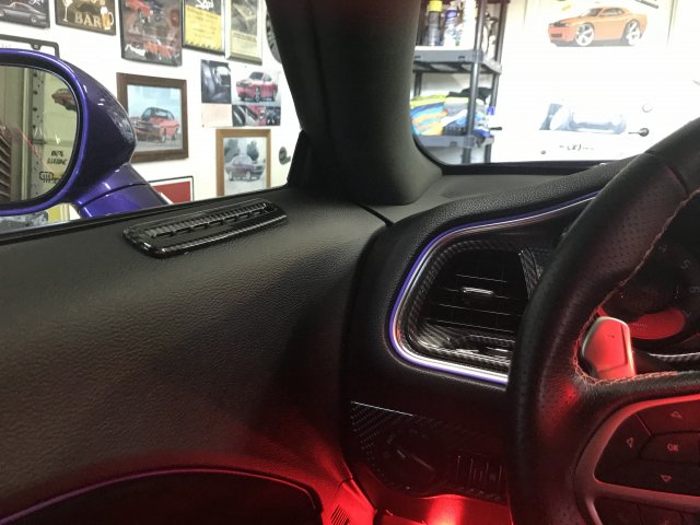

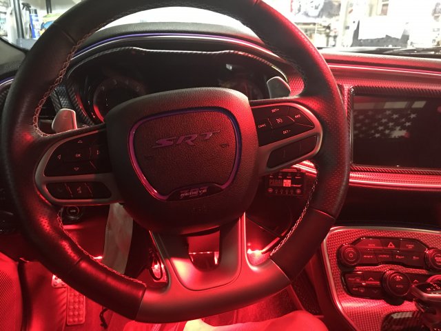

81175F31-4CF0-4AA9-A28C-4EEE828F7981.jpeg 9559D0DD-BC66-4A65-AB52-425C5A1405E8.jpeg C4BD9971-CE84-4679-8F26-05CB4BD73A7F.jpeg
