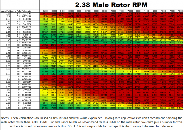

2015 stock long block. 2.69 upper on a max effort ported 2018 2.4 IHI, full race bearing rebuild (snout and bearing plate). I’m contemplating adding a 10% lower with the 2.69 upper. Is this too much boost? Too much rpm for the blower rotors? Are the rotors limited by bearings for rpm?

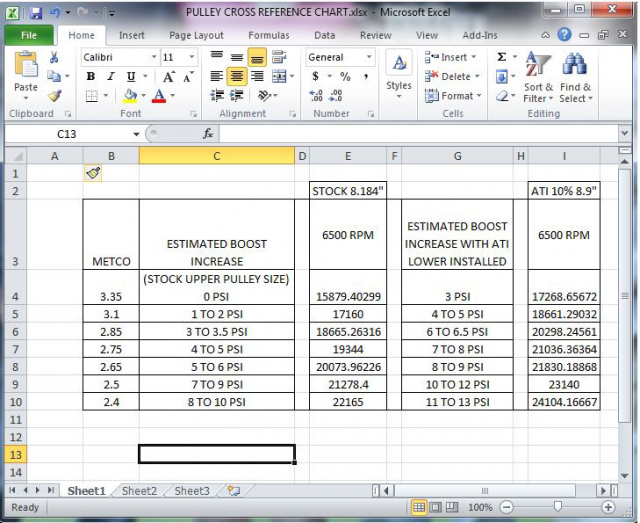

8.9/2.69 x6400rpm=21,174. Stock with 3.35 upper ~ 15,600 at 6400 rpm engine speed. Pushing the limit imho.
57,866
198,537
SDG has a graph it is on the site for rpm

So I have a 2.69 on there now. Kong is doing a full port and race bearing rebuild. 108mm throttle body, and long tubes are inbound. Car has a chiller. Wondering if I’ll lose power without pulleying down a bit more, and what I can realistically pulley down to in the “safe” male rotor rpm range
