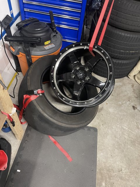

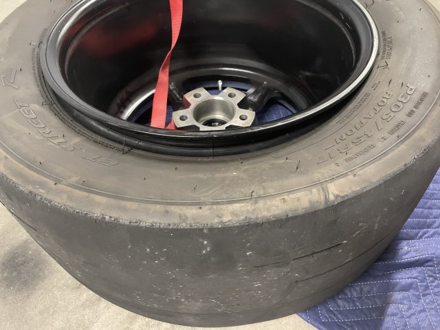

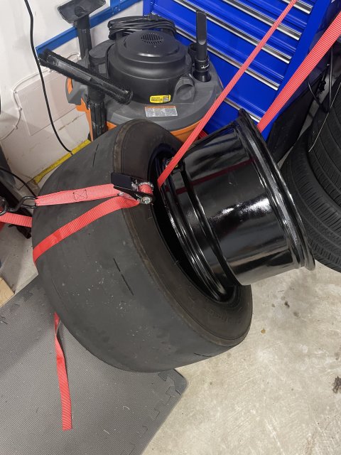

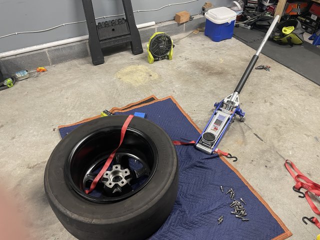

You need to separate the old tire and wheels. I choose a ratchet strap and a jack.
9B2C75F6-482A-44BA-9307-BEF1CF41990B.jpeg 5810B6D8-9660-416B-BB30-EA938F603F3D.jpeg

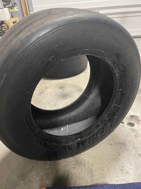

Once the bead is broken you need to separate wheel and tire…
936EDB5A-A7CF-48D9-BE51-2B0E84B3F2BD.jpeg 21B6394C-96E4-4B14-BBDB-DC364D326411.jpeg

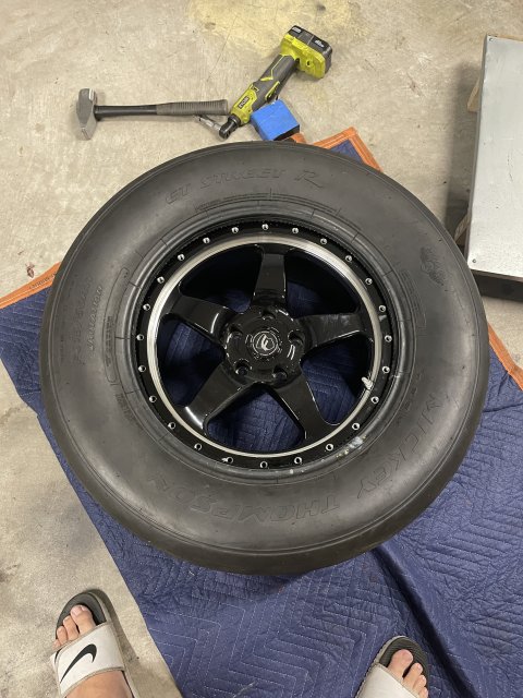

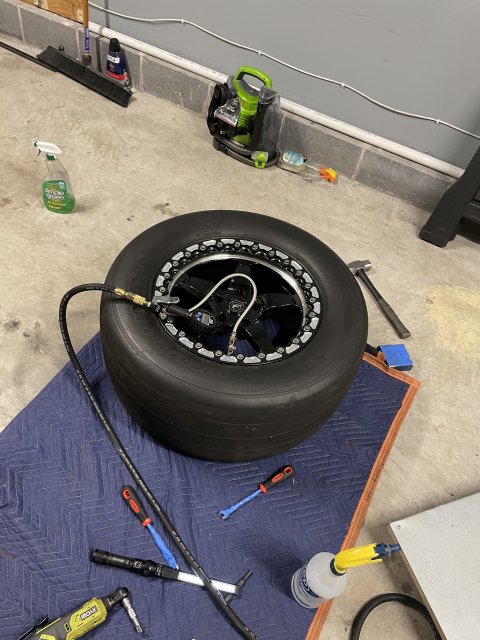

I recommend doing it so that the tpms will clear. Next soapup the back of the tire you are putting on.
plop that biznitch on

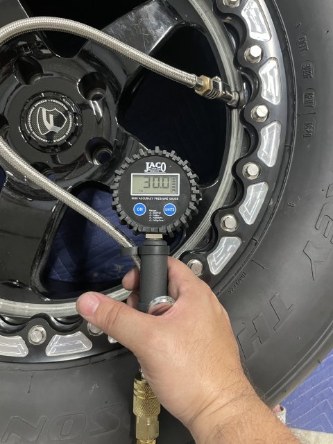

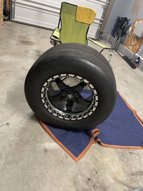

So beadlocks sit in a groove, i recommend stretching the tire in a S, W, N, E configuration. Soapy wooder is your friend. Once you get a direction in the groove use the beadlock ring to clamp it so it wont come out. Im an 800lb gorilla so this shit was easy 👀
Fill with air till you pop the bead back on, it will be loud. Brough me back to when Seaman Timmy fired his shotgun and I didn’t have a chance to put earpro on…

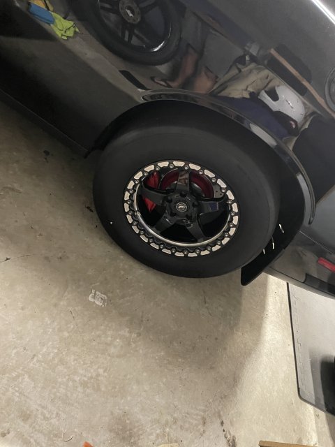

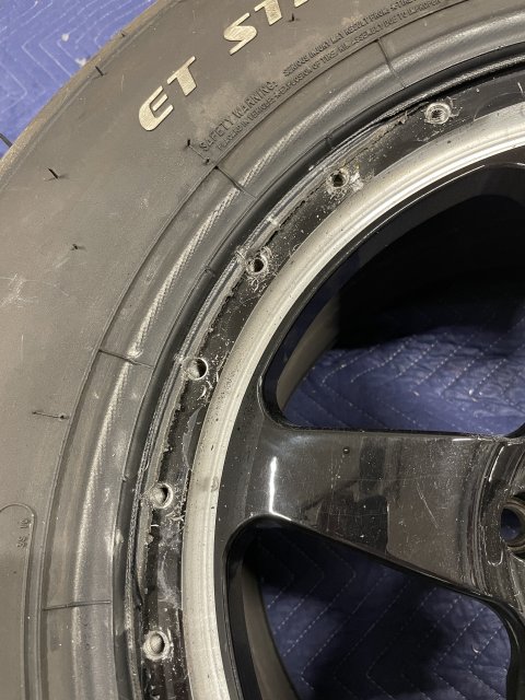

Before filling I torqued down to 10 ft lbs. then did 15, then 18 using a paint pen to mark studs done in a star pattern per Forgestars recommendation. I will have to say this is now a safety concern for me and will be doing my own beadlocks in the future. Discovered a ticking time bomb on the old pair. #mechanik never put the tire in the groove… BADE4A86-5574-4961-B7C7-F560A46F932E.jpeg
hope you enjoyed this fantastic read, off to Mr. Tire tomorrow for a quick balance.

Sooooooo...... How'd you break the bead:geek:? I understand using a jack and ratchet strap, Im just not sure if I understand the how.
You place the strap under the jack, then using one spoke ratchet the tire to the jacking surface. I say about an ince from the rim. So as you use the jack the rachet straps keep the wheel the dame distance from tbe jack as the jack pushes the tire off the bead. Once you break it off just use your feet to push the rest of the tire off.

What pressure did you reach when seating the tire? Bad things can happen.

You need to separate the old tire and wheels. I choose . Discovered a ticking time bomb on the old pair. #mechanik never put the tire in the groove… View attachment 49910
How could that tire not leak if the bead was not seated?

The edge was squeezed tight by the lock, just if it came loose from torqueing on launch...I can just imagine the horror...
looking at the gauge when it popped it was around 5psi
I dont know but I was not not happy to find it.
It would have been horrible. I will be doing my own mounting going forward.

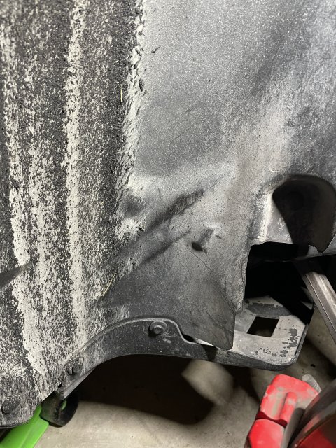

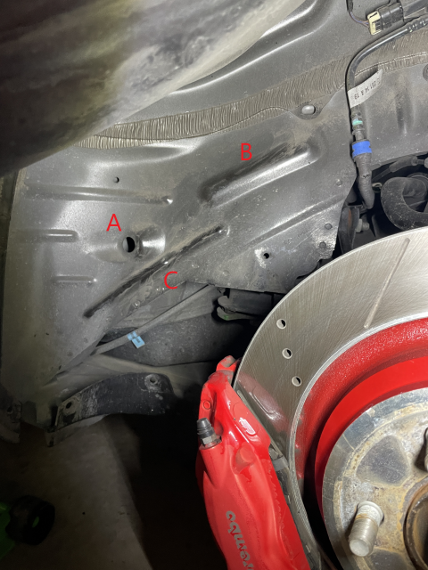

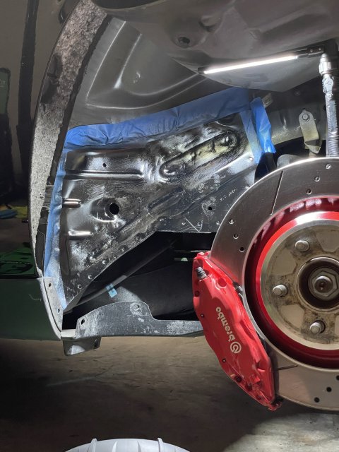

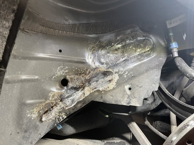

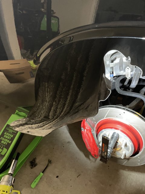

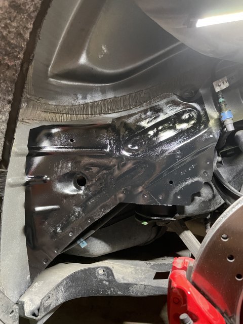

To add to the thread, this is how you bang out your ribs fumanchu-5000 style...
Step 1: notice that with your 305 there was small rubbing (that's what she said...)
Step 2: peel back the banana
Step 3: identify the enemy
Step 4: use torch to heat and a 3lb hammer to basically get some therapy in...
Step 5: sand a little to get ride of crispy paint, clean with acetone and mask off overspray.
(light coats to start off, five minutes apart, did a total of four on each side)
step 6: remove masking, mount wheel and slip finger between (that's what she said...)
Revel in the chonky ass stance she has...
On the other forums @FFBOS mentioned a 3mm spacer, I have them on order. Will drive once the spacers have arrived just for "insurance"...
