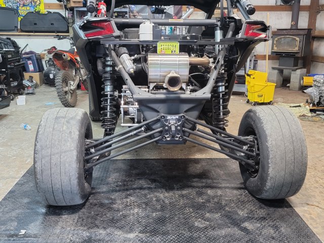

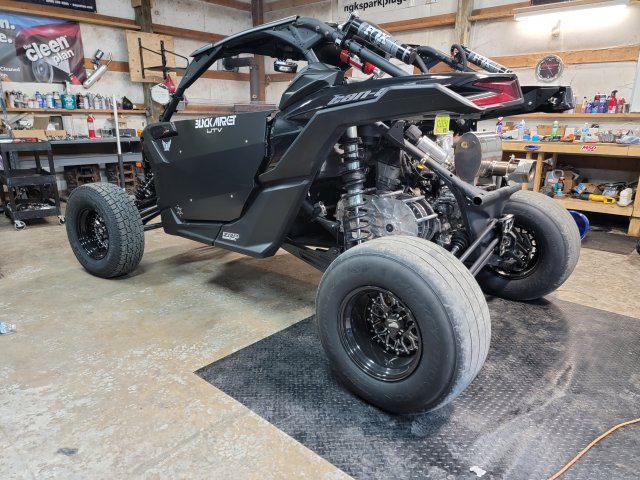

I have i.d 1700's in my can am x3 and it idles great. Over 400 wheel at 40psi on e85.
Interesting...
I am struggling (only some) on the concept of a 1700 series injector in a Can Am... And is it really the same 1700 series injector that a 6.2L Hellcat motor uses?
The fuel flow is the same but the body is smaller. This is a serious build on this car. Full race engine and huge turbo. I cranked it up to 47 psi and was at 95% on the duty cycle lol. Probably 500 wheel hp.
