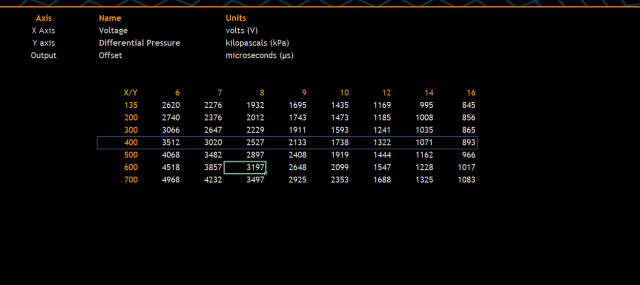

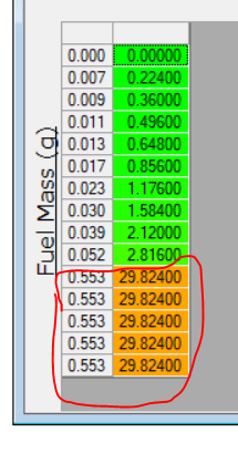

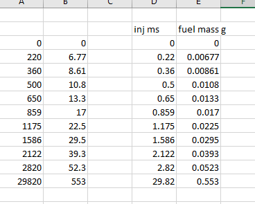

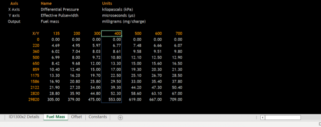

Alright so I hear a lot of hype about the ID injectors. Looking at the old id1300s data was straight forwarded just needed converted but the x2 on the other hand is taking time to decipher what they want. I emailed their support and got another spreadsheet and between the two have somewhat made sense of it.

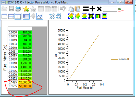

Taking the 400 column and then the y axis I converted to find inj pw vs fuel mass and fuel mass vs inj pw
Converted

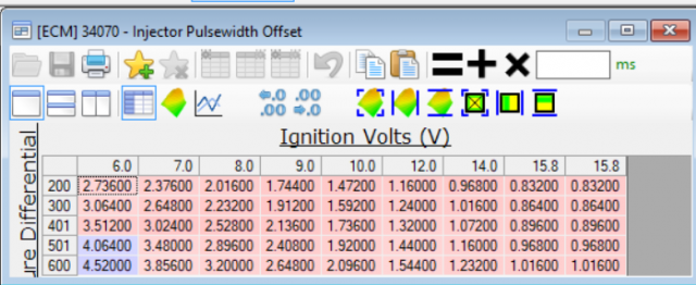

Here is the offset table
Converted

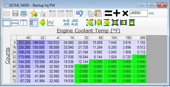

Cranking PW multiplier Table 34000 startup base
ID Startup pw scalar is table 44436 statup inj pw scalar
Min Injector Pulsewidth .125

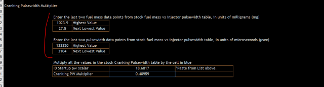

Now here is where I get a bit confused
So what table is it wanting me to enter the last two fuel mass values?

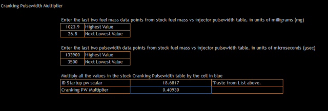

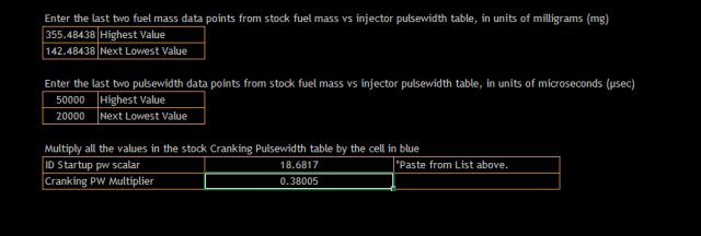

-----EDIT-----
The part I was confused on that I highlighted in red is as simple as entering data from your stock tune into the spread sheet. I had tunnel vision and thought I had to paste the info from the spreadsheet to the stock tune but that was not the case.
It will update the multiplier after you enter the data.

I don't think those values for high/low go in the tune itself, they're used to calculate the multiplier in the blue cells that then gets applied to the cold crank table, that is if I'm reading it all right. I don't remember doing any of that for my 1300X injectors.

How did you know to grab the 400 column/row?

See if this helps. I think what they're trying to do is setup a "scale" for the bigger injectors on the startup table (34000). They're asking you to enter STOCK values and then use the multiplier to set the values in 34000 table, then the value calculated in the spreadsheet for startup inj PW Scalar.
This is the output I get using values from a stock 2018 Hellcat tune file.
So here you simply type in 18.6817 for startup inj pw scalar.
You select the entire table for startup inj pw (34000) and multiply all values by .40930, which seems to make sense considering the 1300x2 are a bigger injector.
Here's what mine gets using the .40930 multiplier applied to a stock 2018 tune file:
This obviously assumes I'm understanding the instructions LOL. This will all just be a starting point anyway, as I've never seen it be perfect right out of the box on any of the injectors I've used.

@Speedy! I assumed the same thing with table 3400 and that is what I did yesterday. So if we both assume it we must be right :p I had all that going yesterday. It could have been worded way better.
The only thing I don't understand is the part I highlighted in red but I'm wondering if it means what I did here. I contact support Monday. I'll post back my findings and a copy of the data in the tune so someone in the future can use it.
