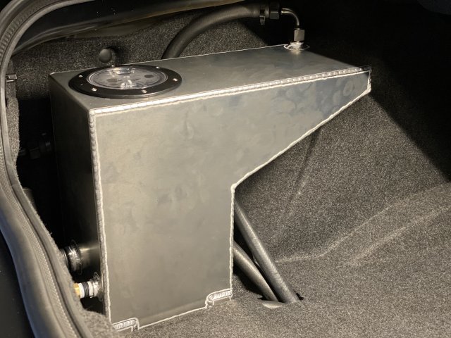

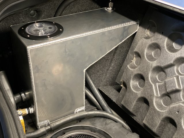

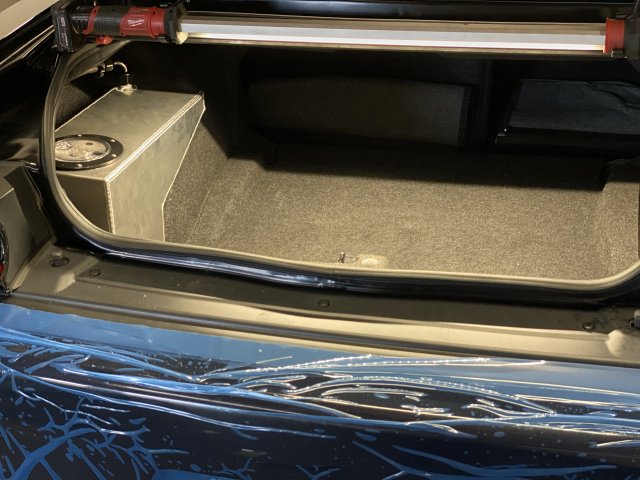

BDEC2936-DF5F-4B2A-B525-E10ED6601158.jpeg 7798D637-DE13-4E43-86D4-80CDD49BB0FD.jpeg 97D0C731-3FCF-45E6-A82C-DCA7854DA360.jpeg
This is what Tommy came up with at SRT AutoWorks. No way in hell I was taking out the subwoofer. It looks nice and clean.

I believe it’s a 6-7 gallon
3,609
11,632
View attachment 12836 View attachment 12837 View attachment 12838
This is the box to have if you want to use a chiller. My FI Interchiller works best using my ice box with about 2 gallons in the tank. That gives me the fastest and coldest temps. Problem with the flat “Charger” version (that I have) is that 2 gallons barely covers the pump intake and any deceleration uncovers that and sucks air. That won’t happen with this “Challenger” version of the tank. To be honest... before going with the interchiller I don’t know which way the coolant was moving thru the exchanger. I don’t know that it matters. I have now removed the exchanger and closed off the inner opening in the fender well that allows the air to move thru it, so that air duct is now functioning as a cold air inlet for the supercharger. After I get everything else done, I may change over to this tank to get that increased efficiency with the interchiller.

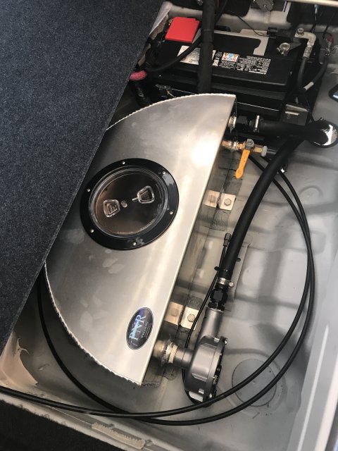

Btw AlleyCat..... Tommy is doing such beautiful installs on these things now you wouldn’t believe it. Using large radius custom fittings they are show car quality. If you are not planning on going to a interchiller and want the type of box I have now, we could possibly work a swap where we put mine in your car and one like James has in mine. 915368D0-C894-4B85-854B-79A1DE1D7FCB.jpeg

I would call PNR Welding and ask them. I think you can buy directly from them and I would guess that they can still make that one. The one thing that is not a plus with that Challenger side mount is the small opening. Most of the stuff made now has the large opening that allows you to stick a whole bag in there. Much better than feeding that small hole and chasing ice cubes.
Bigger than the opening on your half moon ice tank?
3,609
11,632

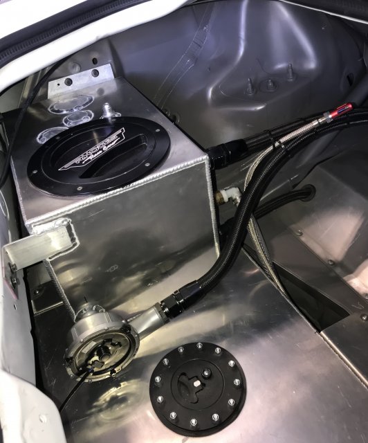

Yes. Too big to even be a option with the side mount PNR. This is what I’m using now. A custom 10 gallon tank. 0D791369-DB17-4368-BA2D-9E8072C5ACAE.jpeg

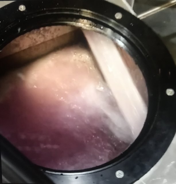

Screen shot of a video showing the flow of coolant returning to the tank with the 1” lines and 40 gpm pump. AC2B8513-D2D1-4BE4-9997-11D86F58AA89.jpeg
