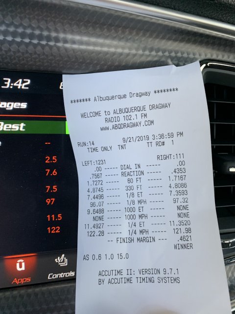

1,553
Just made a pass, DA is 7800, surface elev is 5350. I’m running in the 11.5 class, car ran great! I have 275/40 R 20s Mickey Thompsons on stock rims. Threw 5 gallons of 100 octane unleaded in it. It weighs 4400 even with a half tank. 700 miles on it.

Well I broke out if that's any consellation ;)
1.59 60 foot, 7.2 1/8 mile 11.46 on the brakes! Class I was in was 11.50 and I thought I was going to go rounds...hopefully better next time.
I was down to 95 mph so I think I was on my way to a 11.3 easy, maybe 11.2!
Car was running great at the track, I couldn't watch my shift points but it was winding out real near to...if not at...redline. I was running the same times and speeds as a modded Hellcat with 720 to the wheels!
