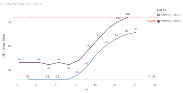

With that said, my Whipple setup does see higher ICT then when I had my stock supercharger. I think the big reason for this is the massive size of the intercooler brick plus it's not well insulated from case so it ends up absorbing a lot of extra heat versus the more efficient and smaller HI design.
For comparison, I just came back from a drive. It's 100F outside, and my ICT settled in around 62-64 after the engine bay became nice and toasty. Does it bother me that it's higher than the 30 and 40's I used to see? Not really, because my IATs are nearly identical to what they were before when driving around. This tells me the intercooler is doing it's job and that it's extracting a lot more heat out of the air then the smaller cores in the stock supercharger.

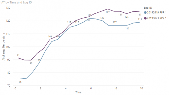

Here are some quick comparisons from the data logs I've collected in similar 90F ambient conditions. The blue line is when I still had the stock supercharger with a 2.50 upper + lower combo with spacers while the purple line is my Whipple with a 4.25 pulley + lower, no spacers. Notice when the ICT starts to climb, it's right around the 9-10 second mark in my passes.
And here were my IATs for the same passes. With the Whipple being purple, it's not that much worst than what I've been able to achieve in the past with the stock supercharger.
I'm quite satisfied with how well my single core Killer Chiller is performing with my Whipple so far. Best of luck to you guys with yours! Hope yall figure it out.
