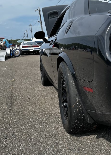

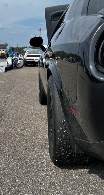

I have a 14mm spacer with narrow body offset 17” wheels and 325/50r17 MT and they still don’t stick out with the flares, also don’t come to the edge either (also +30 mm offset)

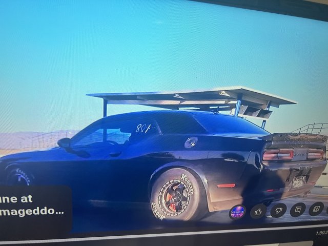

D5 forgestar 17 x 10. 30 mm offset with 15 mm spacer. Huge Hoosiers. Forgot size. Do not stick out. You can see them in videos very clearly.

Froze the video and took picture
