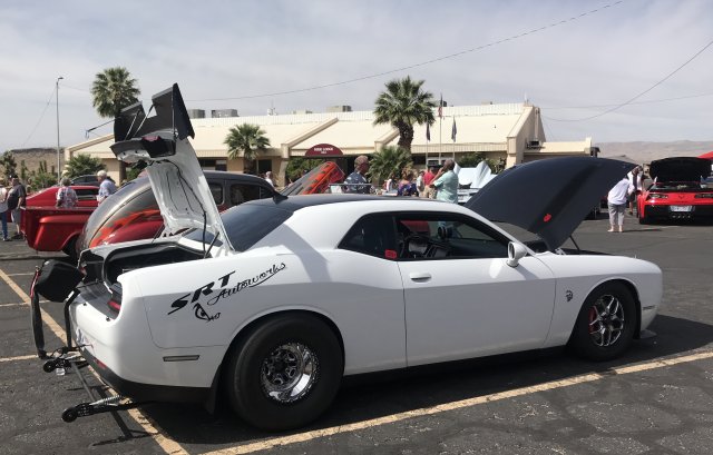

I run a 15x10 with a 315/60 on the rear and a 18x5 on the front. Should that be considered staggered? I like it 😙 3526F15F-31AD-48F4-B87E-9A96C947F821.jpeg
