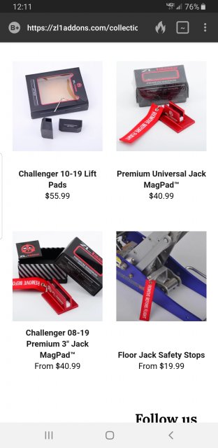

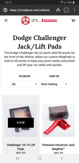

Can you post the adapters, where you got them, and the pricing?
Here's the ones I use. Challenger on fits, well, the Challengers. The U Screenshot_20191229-121104_DuckDuckGo.jpg Screenshot_20191229-121148_DuckDuckGo.jpg niversal one is narrower and fits narrower front lift point on Charger.

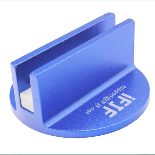

Due to the low cost, I bought one i found on Amazon. Turns out it works very well, fits the challenger pinch weld very well, has the blastic bottom so it doesn't wreck the pinch weld, the magnets are strong enough to hold it in place, etc....I am very pleased since it is so much cheaper too. Also, added bonus this one is available in blue, which nearly matches my B5 Blue car! These are about $15 now, when I bought mine they were about $12.

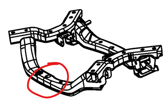

If it isn't designated as a load bearing member (meaning it is reinforced to support the load without collapsing) then I would avoid it. However, if the hole in question is the one circled below then it may be workable. It just looks like a PITA in my HC to access, requiring you to pull out all of the aero panels.
That cross member isn't very sturdy. Ask me how I know.
No, I didn't try lifting from it, but when our Redeye 1.0 arrived at the dealer, that cross member was crunched.
Not that I saw it in person, but what the photos showed wasn't very inspiring from a strength standpoint.
I use the ZL1 Addons adapters but I got the ones that use 2 screws to attach to the pinch welds. That way they are always there. I am aware that some people are afraid the screws will create points where rust can start. I rarely drive my car in the rain. It's not a concern for me.
