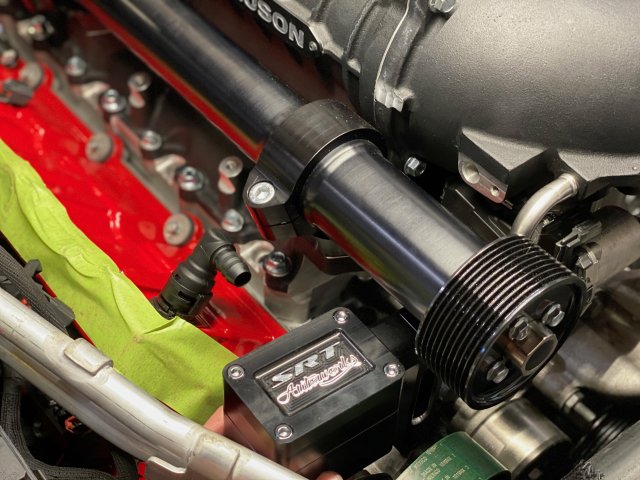

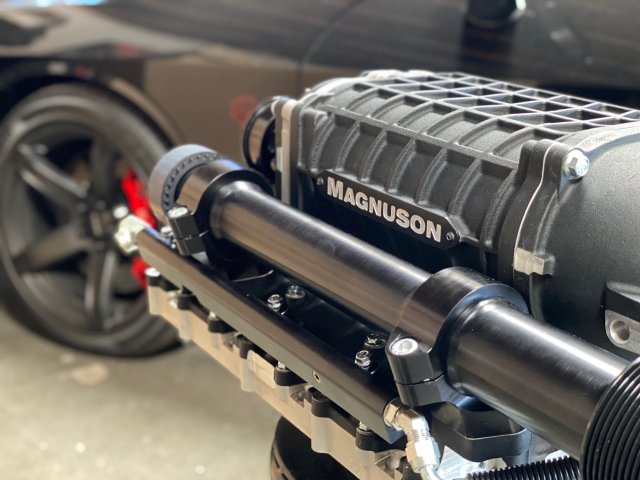

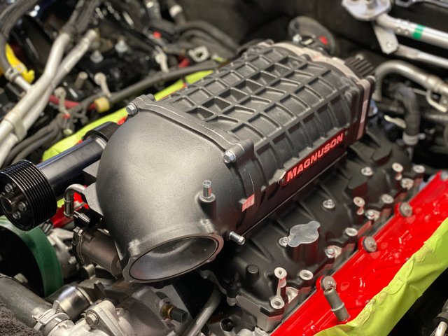

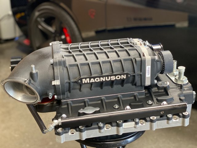

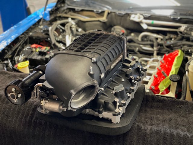

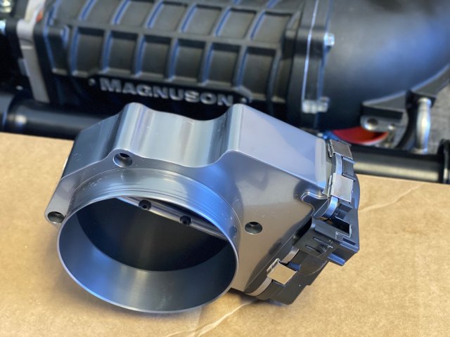

Im thinking there is very few Magnuson SC in the Hellcat community so I thought I would share my build with all of you in here.
Well I found out the hard way is that the stock 2.4L SC is not enough to feed the 426. SRT AutoWorks in Phoenix AZ has done multiple Whipple’s and 1-2 KB’s including Marc’s monster from Hell with the Whipple. So me Tommy & Marc all agreed to say... let’s try something different. So I’m like let’s do it. Quick shout out to Marc! Marc brought to my attention about the Magnuson and it’s upcoming reputation and performance.
So I had the Magnuson sent to Jokerz Performance for their full tilt race port package & it just arrived at Tommy’s shop yesterday. Car put down 954rwhp & 938tq in a 110 degrees heat on a stock blower.
Now with the Magnuson I thinking around 1100rwhp.
Had to upgrade to 1700cc injectors and a Fore triple pump system.🙄lol

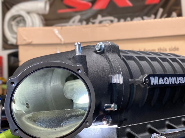

That’s the VMP 105m TB. D934A870-E85F-4F6B-96AA-CFCFB3988564.jpeg 2E1260C0-BA42-44C2-9E19-256E695C648E.jpeg CC371A34-537F-4F65-83C6-8E3C89B1FBCD.jpeg 713A2A10-3293-4DA6-B59F-C6A2A3F7E003.jpeg
IMG_2036.MP4 D934A870-E85F-4F6B-96AA-CFCFB3988564.jpeg CC371A34-537F-4F65-83C6-8E3C89B1FBCD.jpeg 713A2A10-3293-4DA6-B59F-C6A2A3F7E003.jpeg 2E1260C0-BA42-44C2-9E19-256E695C648E.jpeg

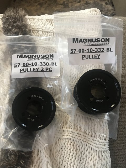

Here is a small update for everyone. Just received these 2 pulley’s from Magnuson yesterday. 3.0 and the 3.25. I ordered them just Incase shit gets really bad in California.

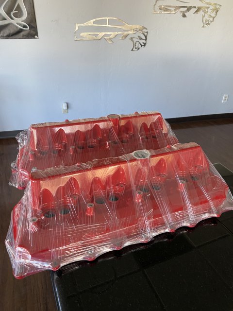

Just waiting on the valve covers to be done. Had them coated red. I can’t stand that hemi Orange lol.

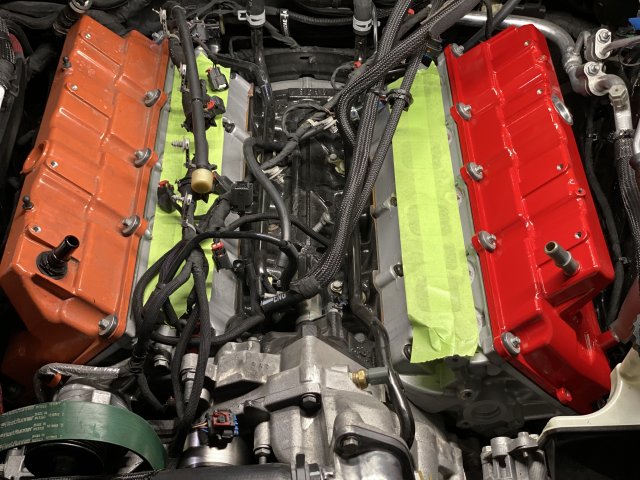

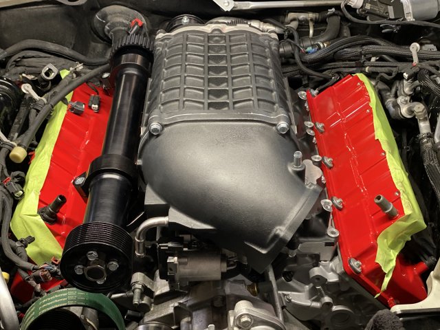

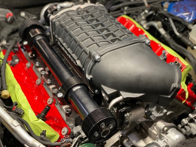

B2EE6A94-068A-4C5B-A659-16E872727A8E.jpeg B42DC2CC-774B-4F37-BFDB-415F967A553F.jpeg
Valve covers are in. Had them coated red. I can’t stand that hemi orange. Super charger should be on by the end of the week. Tommy and Theo are installing the Fore triple pump system today and tomorrow.
