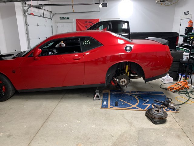

Well today I broke an axle chasing a new PB. Maybe more is broke but for sure it is an axle at this point. Not both axles just the driver side. If I put the car in drive I can hear it go in gear but it just free revs when I hit the gas. Would just the drivers side axle be enough to cause the to happen? IMG_2129.jpg

Any of the u-joints broke?
Can you feel the suspension load when you put it in gear with your foot on the brake, or are you just figuring it's in gear because the shifter matches what you selected?
You could've lost a shift solenoid, but if it was only one solenoid, you should have one of the other selections to move the car.

You can hear the exhaust change when putting it in gear

Does it not move forward or reverse?
Used to be in a normal diff forward was the right axle and reverse was the left.

What do you mean free revs? Does the driveshaft turn when you are in gear and give it gas? Sounds like a broken output shaft in the trans.

How common is that? If it were just an axle would the car move?

Do you know if the DS was turning or not when in gear like @Marc W said ?

I’ll have to look in the morning. I was talking to my cousin tonight he asked the same thing and I said I didn’t check and he hit me in the back of the head and said what are you thinking. I said I was thinking about tearing it apart faster than anything else.

You know I don’t think I ever tried reverse.

First we need to find out what your real problem is though.

When you get time find out if the DS turns when you put it in gear.

If it does then move forward to taking out the axle

We all think it must be a axle when this happens. He did say it wheel hopped and made a boom

Really not to stressed. Not happy because I think with better prep it could be avoided. If it ends up being trans related I won't be happy. Because that means I'll either not build a shop next year or end up selling the bike.
I will say I am pretty positive the driver side axle is bad. The chances of something else who knows
