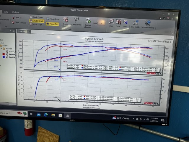

Is that cam you're talking about the one that I have? Power curve is pretty much perfectly linear, definitely did a nice job on it.
For those that haven't seen this, here are the 93 and race gas pulls Jim did in 5th gear. Almost a straight line.
Sure is. You have 1 of the 4 out in the wild!
