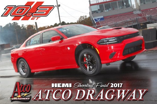

Leave from an idle.

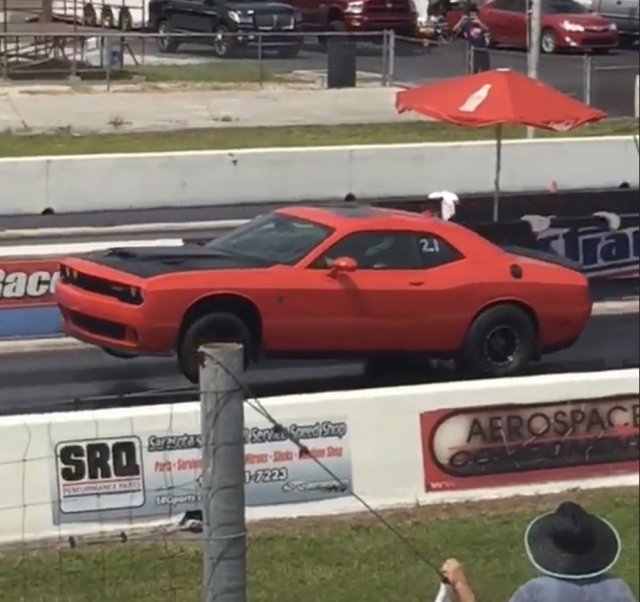

Whoa, crap! Now THAT is hooking! 15" conversion in the back? What is done to your suspension and/or rear end to support such a nice launch?

Demon Springs - 15" conversion - 315/60 radial pros - stock 2.62 with brace - Sphon adjustable arms - and my own chromoly toe links
here's a video

When you guys say idle, you’re not even pre-loading the drivetrain?
Correct - no preloading
