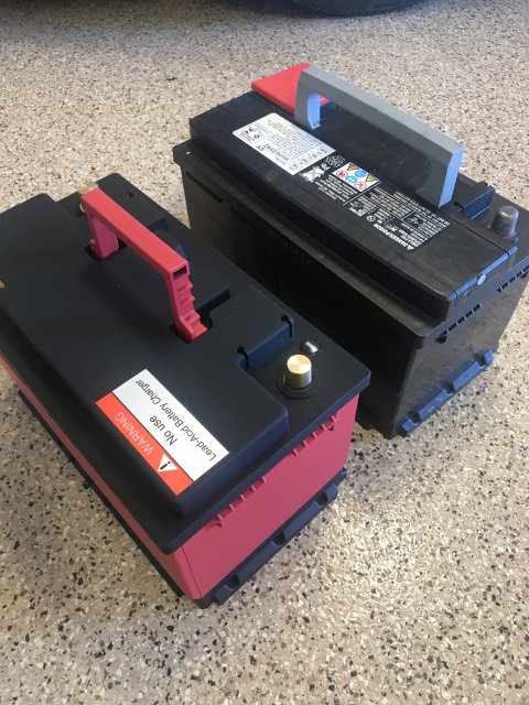

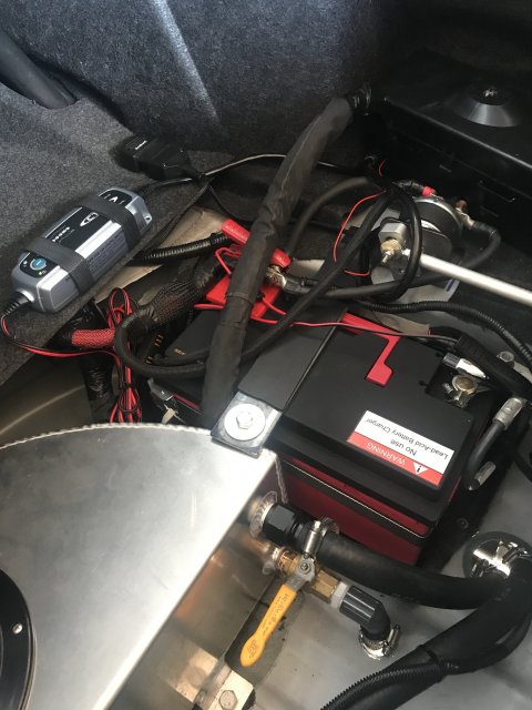

I’ve had one of the Arc Angle’s in mine for some time now. It saved approx 30 lbs and cranks the engine like its on steroids. Much stronger then the OEM. It’s a full size drop in replacement. I haven’t experienced any downside and it has a 10 year warranty. A stock lead acid battery doesn’t last that long so what’s to loose? 9BA942FC-25FE-4C9B-B35E-487B24ECFB39.jpeg 8B154C2A-4E23-4448-8B6F-8D7CD04E2CC1.jpeg
4,981
9,436
^^^ I have the same, & traction is the same even with less weight in the back, these cars are so heavy so can't hurt it with less weight.

What did you guys do about the mounting plate? I've heard some trim and some say a longer bolt?
4,679
24,285
I had no problem mounting mine. I’ve heard others did. Strange.
oilburner
#1135
690
1,744
coboconk
had to trim the hold down 1/4 inch an long gate bolt hole a bit ,sure cranks fast now.
4,870
11,001
The batteries are awesome . ( the arc angel anyway) I had to trim the mounting plate a tad and elongate the hole . You could always the mounting plate from a cop car as it is shorter .
4,981
9,436
I was able to get the bolt started & tightened it down. Changed nothing.
49,392
159,090
Arc angel here, I just bought the longer bolt Bmason said to buy. Never tried the stock one.
