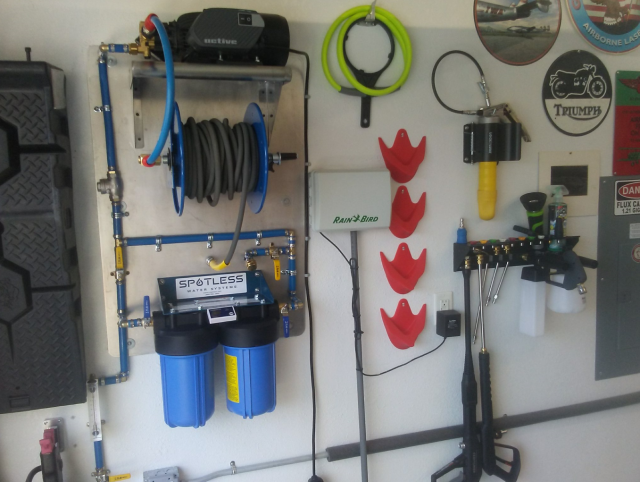

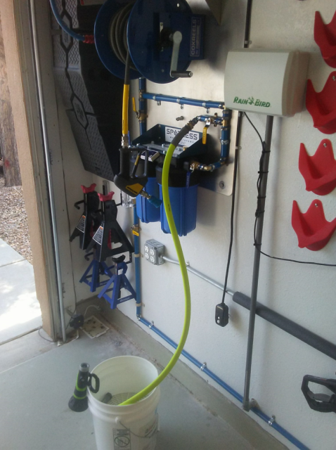

Here is the detailing system I built last year. No need to spend the extra money for the bypass DI filter, just build a manifold with a few valves to do the same thing. This wall mount system has been an absolute game changer for me. It was always such a pain to drag out the machine, cords, hoses and so on. Now I just turn on the water supply valve from my water heater manifold, hit power, and I am washing in no time. Mounted everything to a 3/8" aluminum plate so that when I finally move to a place with a real shop I can just unbolt the entire unit and reinstall in the new shop.
Oh, and the red arrow looking things--- Put one in front of each tire and they keep the pressure washer hose from getting stuck under the tire as you go around the car. Wish I knew about them years ago as the hose getting stuck was always annoying.

Is that the DI-10? What is the difference? Is it just that you need to change the media more frequently"
I like your manifold, I am a DIY'er!

@45-70govt - that's a sweet setup, wish my garage layout would accommodate something like that ! I always wondered if those wheel chauks worked, will have to snap up a set.
@2ndAmend the only difference is the size of the resin containers + his is a wall mount config. If you plan to bring it in & out you will need the model with a frame & wheels. The system would not survive being left outside in the winter but should be OK in a garage.

Dude! That's something like I would do! Are you stealing my ideas??
And what's up with the flow meter?

Flow meter was not really needed, but I had it in my junk pile for years. I added it to verify advertised flow out of the unit, and to give an indication once the pump starts getting tired which should show up as a decrease in flow. If flow ever starts dropping ill order a rebuild kit before the pump grenades itself.
You may also notice the stainless check valve on the supply side. I read something where a guy built a similar system with a cheap pressure washer unit. He also had his water feed coming from the hot water manifold like mine and something went wrong in the unit and it pressurized his hot water heater and burst it. Not sure how that would even work, but he had pics of the damage. Might be a bit OCD but I added it for peace of mind.
100F is the temp limit for my unit. With a tankless water heater its easy to dial in the temp. 100F is not very hot, but it does make a difference when cleaning greasy parts.
If you do build a system get a stubby gun for it. Its so much nicer to use than the old 3' wand type.

Dang @45-70govt that's bad ass. Mine's portable. I need to look in to some kind of manifold that allows me to bypass the resin to make it last longer, although mine is lasting a few years as is.
Only problem I'd have with yours is remembering which valves to open/close :LOL:
