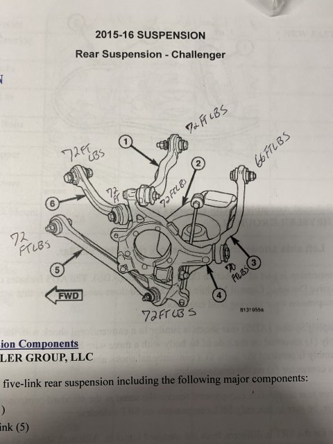

no change of the control arms, still factory. Just printed out all the torque specs and found the part in the FSM where it all has to be torqued under load
6,767
43,063
Let’s hope that does it.
3,533
8,607
Played whack a torque for an hour...
955550B1-830B-4CF6-AE81-B0A729842EC3.jpeg 11EC063F-8F6C-4EF3-8C3E-64D3587617D7.jpeg 69CFBC04-829A-4FE0-B5C6-EE6894CC51C1.jpeg
Didnt fix it. Mike literally ran behind the car as I went left to right and we isolated it to the rear left. With that being said we re torqued everything and did the same procedure. Isolated sound to rear left shock. We are in surgery right now.
