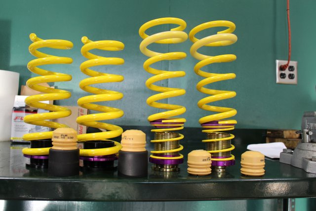

I went with KW adjustable springs and over 30K miles later still real happy with them. I like you can dial them in to the height that suits your fancy. Dropped mine a fuzz over an inch. I did go through CV boot tear problems until I swapped out for Redeye half shafts. So far, so good. Ride is similar to stock but does corner much better. Also will not affect any of the adjustable suspension options. Just have to remember your stock shock travel will be reduced somewhat. I also installed a Bwoody kit, in back, to get the neg. camber dialed back in to spec. Camber bushings will work for a little less money though.

I do a hybrid with the KW’s. Have the KW’s up front at about stock height, but they are superior in their specs up front. Retained the OEM springs in the rear because the OEM is stiffer in the rear and I don’t want to lower it. I like it. After several years the darn fronts need tweaked once in a while because they want to drop a bit. Just glad I can keep doing it.

Luckily the fronts are the easy ones ;)

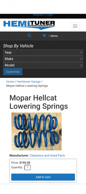

While we are talking about blue Mopar Springs, called Mopar Performance Springs. Does anyone know where to buy them??:mad: I have looked and it seems Mopar has stopped making them! Can’t find them for sale anywhere!
The front KW’s are shot and I want new springs on all four corners now.

I just spent 20 minutes searching, I also couldn't find.
I am guessing that you don't want the more drastic drop that eibachs would give you.

Hunter are you sure those are for at least an SRT? I know there is a set that is for early LX non-SRT models. I am also suspect at that price. Their website delivers 2005 for the year on that set.
9,907
27,371
I was searching for hellcat lowering springs.
But, I was suspicious of the low price also.
