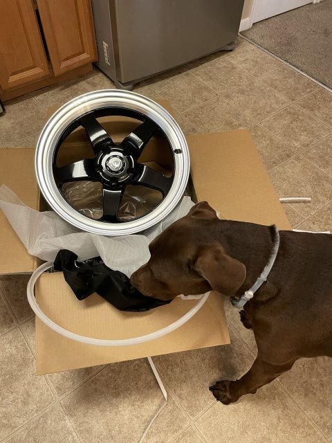

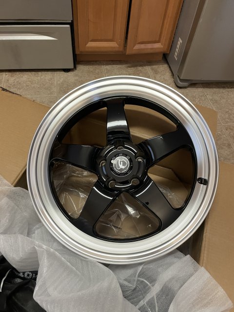

Is anyone running these on their front wheels? https://www.mandhtires.com/M-H-Drag-Tires/M-H-Front-Runner/185-50R18-FRONT I just stold my 18" RaceStars locally with Sportsman S/R. The S/R is a heavy ass tire and I'm looking to replace them with something lighter. I saw these on the site in research and was wondering if anyone has an honest opinion of them? For reference they are going on my new ForgeStar D5 18x5 wheels. Pics of said wheels...
699137BC-2610-4E48-B115-5EBC94692FA0.jpeg 77446965-28B9-4CB3-A62D-B3F216BF69E3.jpeg
Puppers was very angry when I had to explain they were for the cat, not him…

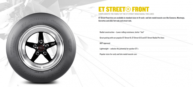

Research led me to these:
https://www.mickeythompsontires.com/drag-tires/et-street-front
Radial construction, 7lbs lighter per tire. Got them and will have them on wheels come Wednesday. Will be doing a test n' tune with them on Friday.
Nice, I've looked at these b4, let us know how they do, track & street.
The thing that would be worrisome for street use is the max load rating 1140 compared to 1650 on the SR.
On a NA challenger I'm sure their fine but with the heavier HC car & engine those tires may be pushing the max load for the street.
The SR was specifically designed for the HC in mind for max load.

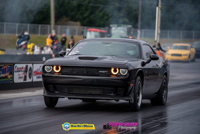

They are just fine. If youre worried about load rating then get the S/R, I’m not, heres why. M&H doesnt post a load rating on their website for their DOT radial. Hoosier doesnt post a load rating on their website for their DOT radial. 🤷🏻‍♂️ I drove to Cecil and back which is 63 miles each way, made multple passes and even got this beautiful picture.
Had zero issues at the track. Proper inflation plus driving like a normal human and you will have no problems. Would I daily them? No.

That is a nice pic !
