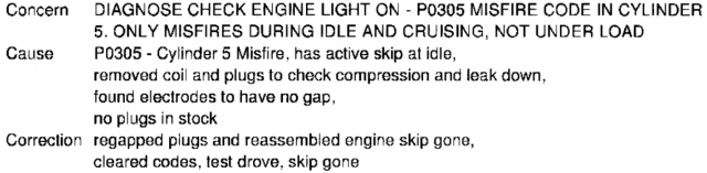

Update
I dropped it off and the tech found both plugs for cylinder 5 to have no gap! I'm hoping this was a manufacturing mistake when the plugs were originally installed. I've never heard of this happening to any other Hellcat forum members. I've put roughly 100 miles on after picking it up and so far it's been running great now.
This is a copy of the dealer work order.
4,679
24,281
Update
No gap. WTF
2,695
Assembly line carelessness? Dropped plugs on assembly and just put in. Or plugs were dropped in boxes on delivery and no one checked gap coming out of boxes and going in motor.
