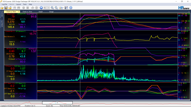

I got tuned up on MS109 and made a couple 1/8 mile passes Friday, 1st one spun, did an easier launch on the 2nd and ran a 6.61x @110, with a soft 1.59 60ft.
The car cut's 1.51xx 60's with his 93 tune and literally zero timing offt he line, and runs 6.65x @110 just mashing the gas off idle,
But I'm not sure what he's got going on with the shifting on this "Race Gas Tune"
Thank you for your time and support,

Your throttle ramp in on this run was pretty soft for sure, over 1.5 seconds to full throttle. Everything looks safe - fuel trims are good, knock sensors are not showing any voltage above normal, etc. You should consider logging a few different channels - you are not logging air charge (good indicator of hp engine is making) or post blower IAT (the one you want to watch). Feel free to PM for a data log channel configuration to give you a few ideas of other things to data log. See attached-actual run is far into the log, had the scanner logging for a while in the staging lanes

Thanks for the reply, My tuner said everything looked good to him also. Basically told me I needed a bigger tire.
OK then, Since I wore out my 'little' 275 M&H DR's , I picked up a pair of the 325 Hoosier DR2's. MY God those things are HUGE.
He can't say I got little tires now, LOL
I got back out yesterday and was cutting 1,51xx 60's and a best 6,58 @111.36. That was on a Hot Lap after a 6,60 @110.
He sent me a channel list for data logging but it would not load for some reason.

Logging trans pids can give HPT heartburn and may explain why the shifts look funny, assuming the car "felt" OK.
I don't feel or hear any funny shifts going on, Logs on the 93 tune don't have that funny looking shift pattern.
I'm stopping by the tuner tomorrow and he'll load a config file he want's me use for logging.

I put your log in my dashboard, everything looks good. You are very rich, commanding more that 11.5 at times. However that is a conversation between you and your tuner.
Air temps are getting high but that comes with the territory. For 60' the combination is prep + tire sidewall + launch at approximately 1500 rpm. Anything higher and you could flash the converter (year dependent).
