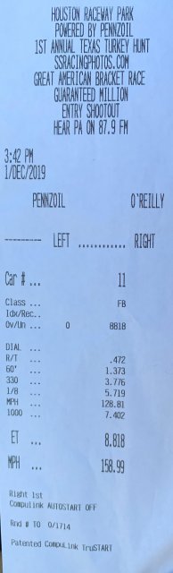

I thought I was done for the year but I just had this itch to try and validate some TCM tweaks I've been working on. There's only so much "testing" you can do on the street before it's time you know? I just couldn't wait until next year to answer my own questions.

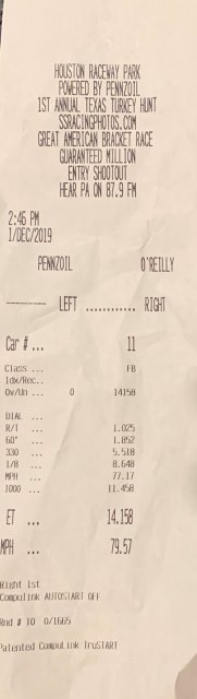

For my 1st pass, I had a pretty hot tune up from the last time I was out there. That probably wasn't the brightest idea. At least I did get to test out my shifts and it felt great going down the track.

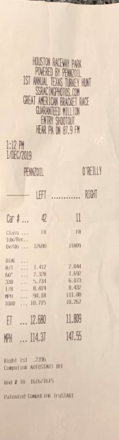

The data log looked great, so I took a little power out for the launch and went for a 2nd pass. It spun and hopped again unfortunately.
After the 2nd attempt, I realized that I was working with a challenging track surface, so I changed my strategy. I neutered the tune up and took a softer approach which then led to my 8.818 @ 158.99 mph pass. A new personal best and a new Hellcat Charger record! What a surprise!

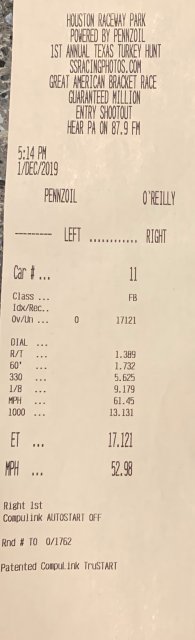

My work wasn't done though. Parts needed to be tested and I need to be able to do rounds if I'm going to compete again next year, so I kept at it.
For my 4th pass, I tried turning it up a touch but that didn’t work out so let's just have some fun and see if I can make some a-b passes to finish out the night.

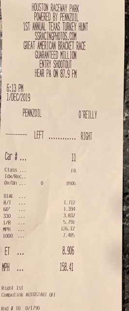

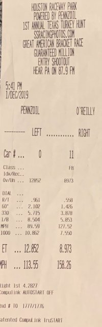

5th pass was an 8.973 @ 158.26 and my final pass was an 8.906 @ 158.41.
I've said it before and I'll say it again, I couldn't be happier with how well this car is performing. This was a nice way to finish out the race season and I can't wait to see what's in store for 2020, not just for myself but for everyone else who's pushing this platform to new heights.
In the video I’m sharing, I included all my botched launches along with my clean passes in chronological order from 1 through 6. Timeslips also attached for your viewing pleasure. Thanks again everyone for your kind words and support!
Timeslip Pass 1.jpg Timeslip Pass 2.jpg Timeslip Pass 3 8.818 158.99.jpg Timeslip Pass 4.jpg Timeslip Pass 5.jpg Timeslip Pass 6.jpg
