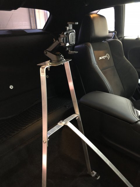

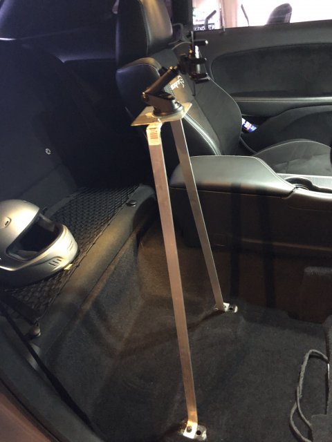

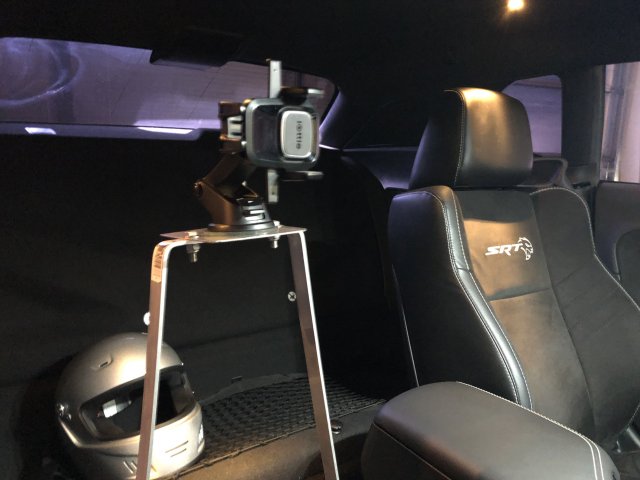

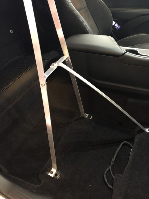

As the title says, it's something that I came up with & made to video my Performance Pages gauges when at the track, b4, during & after each pass to see how things look, since I always pull my front pass. seat for the track it's a good place for this Tripod mount. I don't data log so this is my data logging, lol. It's tall enough to also video out the windshield if I want. It came out pretty nice & study, I haven't done a test drive yet or to the track but soon. It's 1" aluminum flat bar, 4" x 4" top ss plate, some cutting, bending & drilling, bolt it together. I used the factory seat bolts to bolt it down.
Let me know what yall think ?

Update on this thing, it sucks, vibrates too much for the iPhone camera / video, maybe I'll get a Go pro with suction mount & can use it on the inside & outside.
