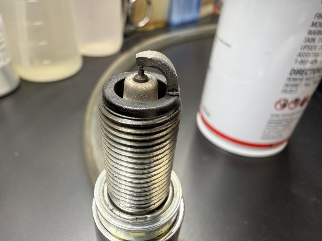

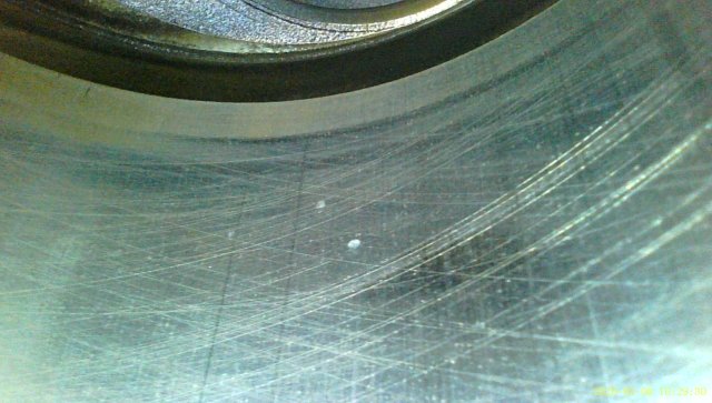

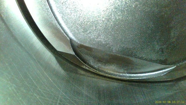

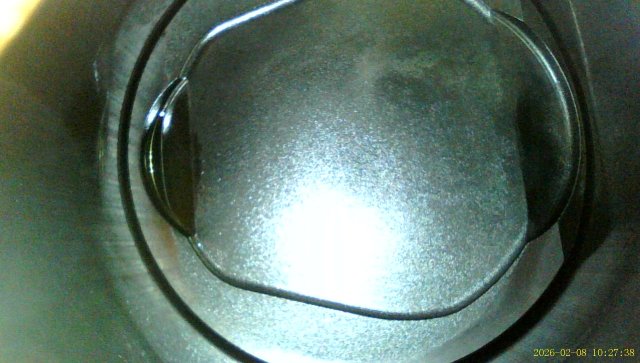

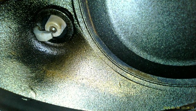

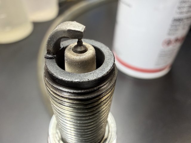

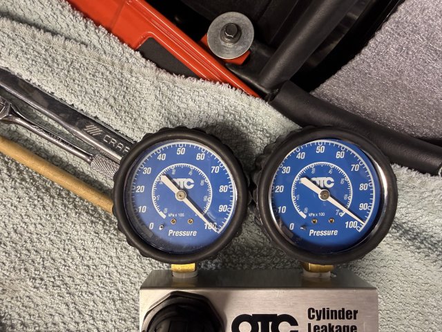

#7, easy peasy, 5 minutes to get them 2 out.
And #7 has been one of the ones with the highest failure rates. I just checked mine, was only going to look at number seven, which turned into looking at them and then doing a leak down test and then it turned into well, I might as well do 5, and then 3, and then 1, and they were all perfect and I was going to be happy with that but unfortunately, I had to do the other side as well because I had to know lol. Number eight was a real bastard, getting the coil power plugs off is the biggest PITA in my opinion at least.
7000 miles on these plugs on corn, the dust on them is from my last Whipple (warranty replacement #6 Whipple) that dusted my engine with aluminum, that was my last Whipple!!
IMG_7094.jpeg IMG_7101.jpeg IMG_7100.jpeg IMG_7143.jpeg IMG_7147.jpeg IMG_7146.jpeg IMG_7138.jpeg
View attachment 178211 View attachment 178212 View attachment 178214 View attachment 178216 View attachment 178217 View attachment 178218 View attachment 178219
Leak down results? Good?
