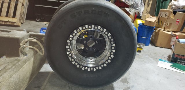

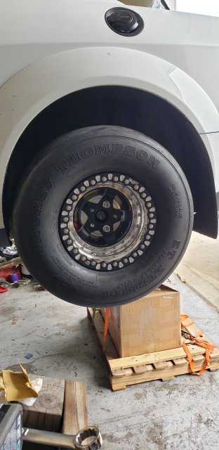

Hole shot wheels in florida made me there first set of wheels 15 x10 inch for my demon 16.2 lbs tire is 315-60-15 mickey pro radial,17 setup should be faster but as the track goes away i will have an option.
27,250
Those are nice. Your gonna get lots of wrinkle with those tires. Any pics mounted on the car.

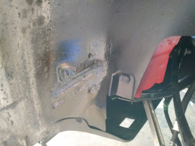

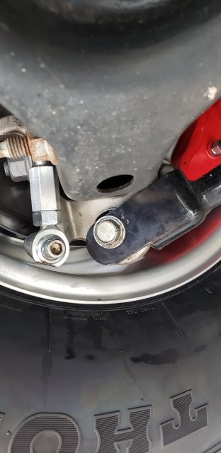

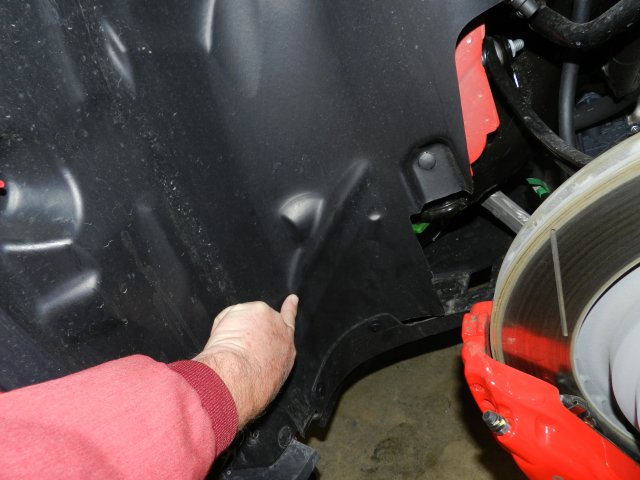

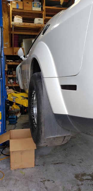

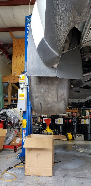

Have Billet Specialties. On 315/17 MT rubbing little inside wheelwell, did you use spacers!
DRAGRCR
#1181
1,561
5,132
VICTORVILLE
MANGO D170
It sounds like you have the wrong wheels. Billet Specialties makes 2 different 17X10 wheels for Challengers. One is for the narrow body and the other is for the wide body. Narrow Body is 6.5" back space and Wide Body is 5.25" back space.
Have the 5.25’s 🤷‍♂️🤷‍♂️

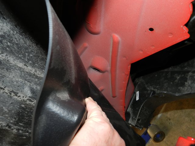

I would double check the back space with a ruler. After that you are going to have to take down that rib. I have done it a bunch of times using different methods. If you don't need much just put some large head rivits in the tub to flush it out with the frame and go at it with a grinder. Plastic, metal and all. Throw some metal HVAC tape over and spray paint it. Simple. No?
View attachment 41224 View attachment 41226 View attachment 41227
Yea, was gonna just take lump mini sledge to it.. 😜
