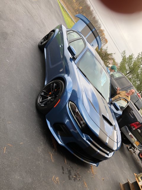

I don’t have any good ones but my wife took this when it was delivered 043DE9B2-1AD8-4F94-8A08-2CF262AD4A3B.jpeg
Congrats on your WB & Welcome to Hellcat Nation !
Post some pics when you can.
Sucks your already having problem, but I have no clue, haven't heard of that one ?
Hopefully you'll get it fixed ASAP.
thanks

She is a beaut! Hope you get issues sorted quickly, enjoy and be safe.

If I were in the market for a Charger Hellcat, that's the one I'd pick! I like the color with the stripes!
-Sorry to hear you're having an issue with it already.....hopefully its nothing major and the last issue you see with it. You would think since you just bought it, that dealer would bump you up in line to have it diagnosed at least. Maybe @DodgeCares can do something....
