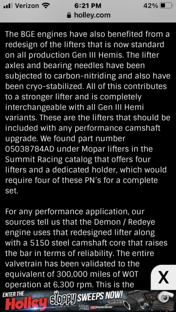

A bit yes from the Johnson lifters. They all well engineered and after 2018 all Hellcat and RE engines were fitted with them. I’ve never read of any failures or issues with them. The 170 uses them as well including the same RE cam shaft.

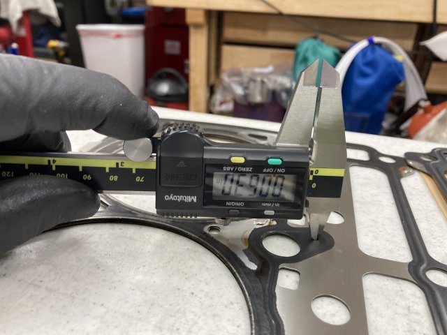

Problem with the lifters in these engines is how they’re oiled. The oil takes a long path that has many leak points, starts up through the heads through 2 orfices in each head gasket which where increased in diameter in 2018 too, then into the lifter stands in only 2 places per head, pressurizes the hollow rocker shafts, oil enters each rocker arm, 16 of them and travels to the tips where it enters the push rod through its round tip, travels down the pushrod then is supposed to pressurize and oil the lifter through that unsealed ball connection and no direct oiling of the rollers, their only splashed lubed from what leaks. I’ve heard of many collapsed Johnson lifters but not many if ever stock RE lifters. Johnson just had a recall on lifters I think?

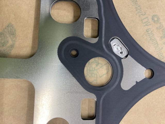

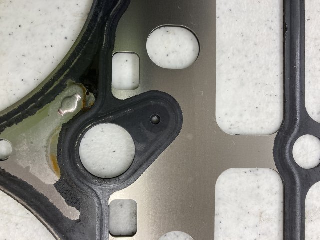

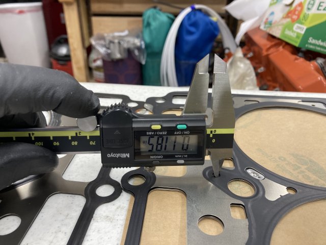

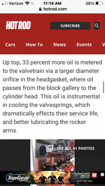

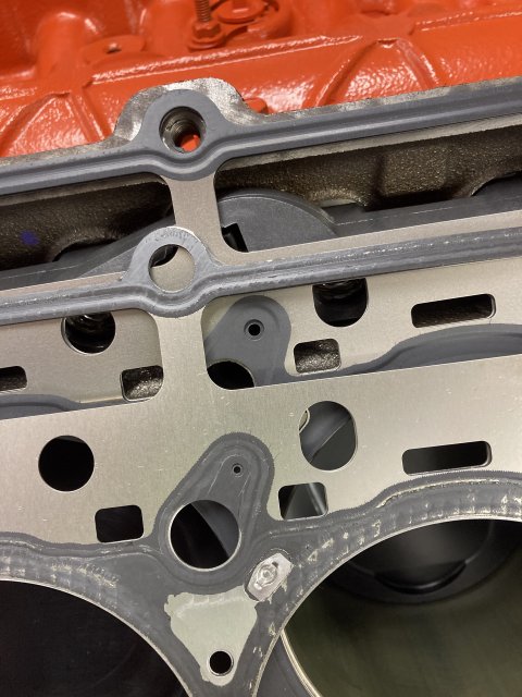

Just the head gaskets, that’s the advertised RE improvement of 33% more oiling to the valve train assembly, the only change was orfice size was increased in the head gasket. Aftermarket head gaskets like the Cometic MLX gaskets still use the smaller orfice size, you have to drill them out if you want more oil up top. It’s why I think some builders have lifter and oiling issues up top because no one notice's this.

I thought there was only one part number for the factory head gaskets. What is the redeye part numbers?
7,726
6,534
That looks like a huge difference!
Factory head gasket are all the RE design now, but every aftermarket one I’ve seen still uses the smaller orifice hole size of the original design
