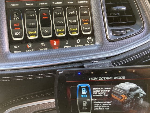

Hello,
My name is Armando Solis Jr., and I recently had the Stage II kit installed on my 2022 Dodge Hellcat Redeye Widebody Jailbreak. The installation was completed about a month ago by a dealership located approximately six hours from me. Due to my busy work schedule, I haven’t had many opportunities to drive the car since the upgrade.
I was under the impression that the dealership would fill the tank with some 100-octane fuel post-installation to confirm everything was functioning correctly. I finally had a chance to fill it myself with 100-octane and noticed that while the tuner shows the vehicle can be put in HO (High Output) Mode, the Uconnect display still reads 837 horsepower.
I’ve read that this may be a known issue, but I’m surprised it hasn’t been resolved more than a year(s) after the release. I would appreciate any updates or insights from the Direct Connection team or others who may have experienced this. I didn’t raise the issue with the dealer initially, as I wasn’t aware this discrepancy existed.
For a nearly $5,000 upgrade, I expected this to be addressed. I apologize if this sounds like venting—it’s my first post here, and I genuinely love the car. That said, I’d like to confirm whether my vehicle is currently delivering the full 885 horsepower in HO Mode, despite the Uconnect display still reading 837.
Thank you in advance for your help and clarification.

Thank you for the advice. I really appreciate it. Nope. Still not fixed and it it is what it is. Take care Sir!! I spoke directly with Dodge Direct Connection this morning. Lady(won't mention names for privacy-I am a quick learner),
was told if I have the correct octane, I can press on the tuner the HO Mode and the light with come on and stay on. If you have 93 or below, you can still press the HO Mode button and it will come on but the first time you romp on it, the knock sensors will detect the wrong octane is being used and will automatically go back to the lower mode. As for the dash display still reading 837, there is no fix, and by her tone of voice, it doesn't look like there will be a fix anytime soon. It will still read 837 regardless of mode. Oh well, kind of a let down but I still love my car!!
