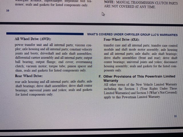

I’m going to the dodge dealership manana, 0800 to get then to fix it with the upgrade. Checked warranty and it should be covered.
