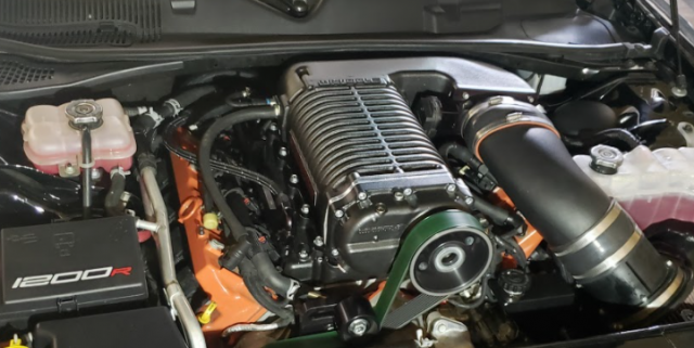

Okay to drive the car to the paint shop with no supercharger coolant?
MurderCat
#3104
325
697
Rochester
Not sure if this is a great idea.
Wouldn't be going past 50mph or into boost. Date to fix the cooling/interchiller on the 4.5L whipple cat is about 3 months out so would give time to fix paint/body work issues in the meantime.
Any risk of damaging the S/C or cooling system even more? Can wait but would be ideal to get the paint/body work done so this car is ready just in time for nice weather. (y):unsure:

Nope, decided against it and will just wait. One shop said it was okay, another said to pull the IC fuse. Don't really need any more damage so mission aborted. Could trailer it over to paint but not paying someone to go 10 miles.

Not a good idea ever, I mean just because you are not in boost doesn't mean the pulley isn't spinning and making heat.

I'd be more concerned about the coolant pump than I would be about lack of charge air cooling in what should be basically a bypass/vacuum condition for the motor.

There are supercharged cars without intercoolers. I would pull the fuse for the pump so it isn't running like Bull said and drive it

Pump with no fluid is a no no. You might make it, but you'll have taken some life span off that pump and it might drop out on you at an inopportune moment. Borrow a friends trailer. If I was nearby I'd be over there with my flatbed this weekend.
