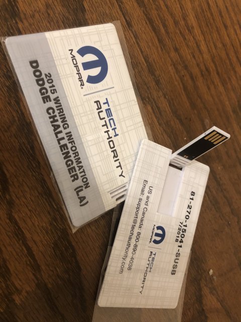

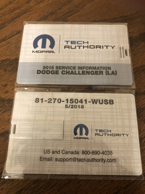

After some searching I found a Service Manual for my year (2015) which included information on the Hellcat. I don't think they publish paper anymore, so mine is USB card which means I have to look on a computer... but it works.
7F485D21-B23A-4D6A-AD5E-105961CA8285.jpeg One is a Service Manual and the other is wiring (I ordered both)
