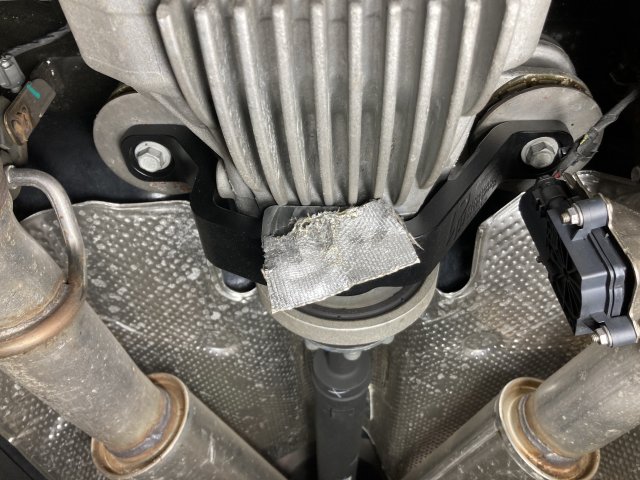

I was under the car re-torquing the P4D diff brace bolts and noticed the rubber isolator and heat resistant tape on the race brace had slipped out of position, pretty sure this is a common problem, should I just pull it off and don’t worry about it or take the brace off and try to re-install it?
2,381
6,598
Mine has moved a bit as well, but not that much. I’ll move it back when I put the car up for the winter. Per the instructions I have, they recommend safety wiring the pad in place, but still mine has moved. I wouldn't let it go metal to metal for fear of damaging the fins. Pls get back to us with your fix. Thanks.
29,446
130,680
I have mine checked all the time and he's never said anything about it...

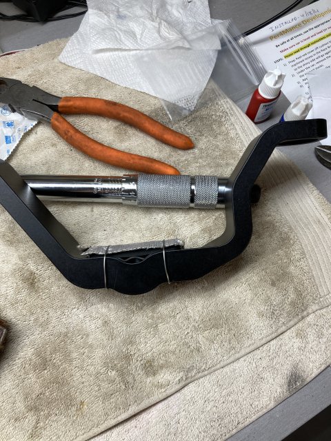

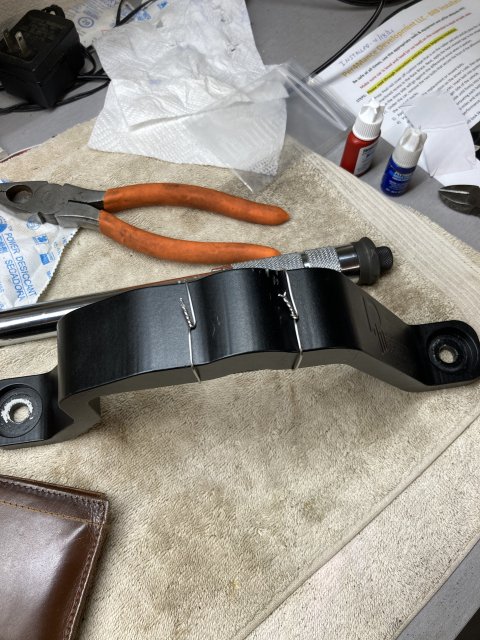

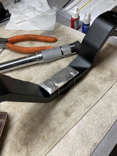

Thread Starter #14
Received new isolator pad and heat tape with some lock wire to try and hold it in place from P4D. hope it works. Very pleased with the quick response from performance development.
