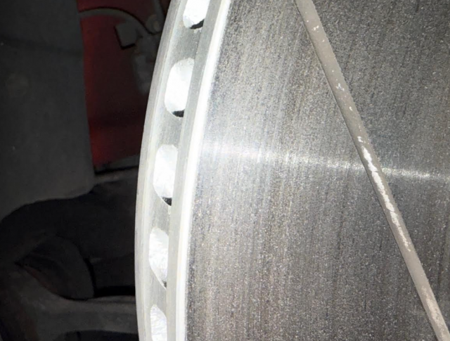

Hellcat
2015 Challenger Hellcat.

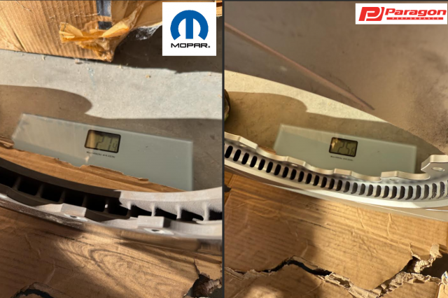

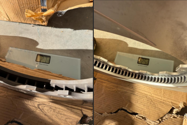

Using the Paragon Front replacement rings with OEM hats and ~3.6lbs weight savings per front rotor. Notably, the turn-in effort is less compared to OEM.
After bedding, the brakes felt "not as confident" on initial stopping and then I realized I was using the NOA Ceramic pads from Brembo (venture to say this is why the 390mm to 400mm front rotor)
I've got the semi-metallic on the way and can compare soon.
Overall, it's nice to the brake maintenance budget to pay $725 for the rotor ring set vs. $725+ for one OEM front rotor, and use the original OEM front hats.
OEM Rings + Hat (est. 31 lbs new and 29.2 lbs worn)
OEM ring: 27.4 lbs (worn, est. +1.8 lbs heavier when new for 29.2 lbs).
OEM hat: 1.8 lbs
Paragon Dual 2-piece Rotor Front Rings + OEM Hat (est. 27.4 lbs new 390mm and 28.1 lbs 400mm)
Paragon ring: 25.6 lbs (390mm ring)
2015-2020 (390mm): https://paragonbrakes.com/15-4-front-rotor-rings-15-20-charger-challenger-srt-hellcat/) as a direct swap from the OEM hats.
2021+ (400mm): https://paragonbrakes.com/2-piece-r...34mm-21-dodge-charger-challenger-srt-hellcat/
OEM hat: 1.8 lbs
ACDelco Dual Slotted Rear Rotors (350mm)
ACDelco:
24lbs Part# Gold 18A2677
Paragon: They offer a rear set with hats for ~$950 and replacement rings for $600.
Front Pads:
Brembo P37018 (15mm thick, 93mm height) Semi-Metallic, Performance
Brembo P37018N (16mm thick, 93mm height) Ceramic, Dust Reduction, Non-Asbestos Organic (NOA)
Rear Pads:
Brembo P11024 (15mm thick, 69mm height) Semi-Metallic, Performance
Brembo P11024N (15mm thick, 69mm height) Ceramic, Dust Reduction, Non-Asbestos Organic (NOA)

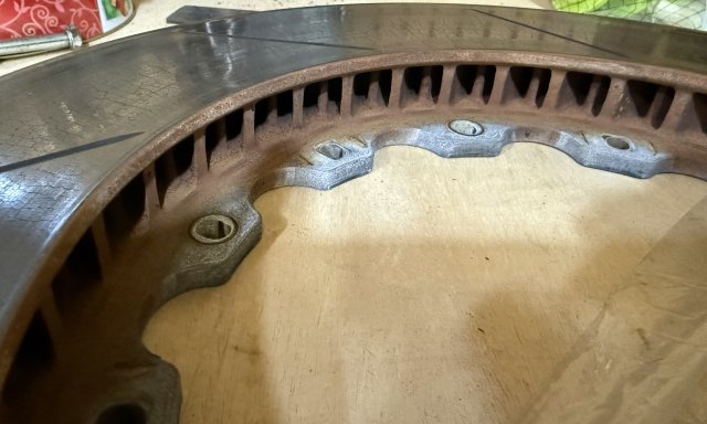

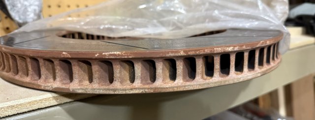

Giro’ outside and inside shots…
16,044
50,313
7,787
48,980
Dude! Where's all that rust from?
: p
HA! Not used in I don’t know how many years. Not since 2019 anyway. Left those for dead because they chattered a bit. I know they have not been on the RE. I think they just need hammered real hard because my current set does that (on the track) if you don’t bust down hard all the time.

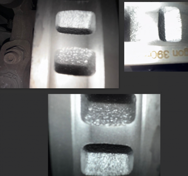

Seems like Girodisc has a straight cut vs. the curved cut of the Paragon.
From what I can see, I believe Paragon manufactures their rotors given the large variety they have to match with hats.
